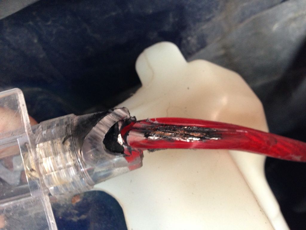

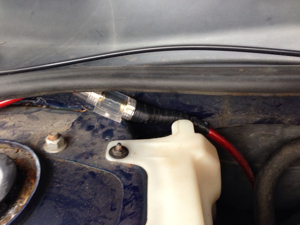

    I also nearly averted disaster:
    It musta got moved somehow...
    Fixed for now, will replace another time:

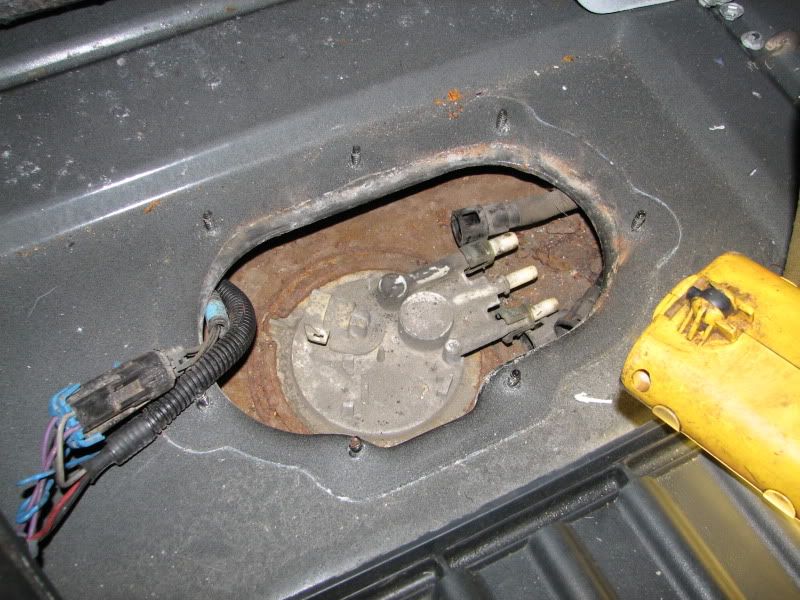

    Yea... sixth gen prix' are 16.5 gallon tanks right? I know my fifth gen is but never checked the other one lol if its a larger tank then that would explain a lot. On the bright side if the mpg stays consistent then I should be able to get 455 miles out of this tank. Was gonna put my new fuel sending unit in but not sure if I should wait til I use a little more gas first don't wanna pull the fuel pump out and have the gas overflow out when I pull it out. any opinion on that?
    im thinking 96 and older you need to drop the tank, so run it low, low , low lol
    97 and up have the trap door in the trunk. where at 3/4 or less of a tank would be ok to pop it out.

    ive looked for this trap door on my 05.. couldnt see one.. whats it look like besides a door lol

  6. #8326 Re: What did you do to your Car today?
    Fold down rear seat
    Pull up carpet in truck
    Pull up insulation in truck
    should be dead center a little way in.

    i have to ask how did this happen? and was that on the fuse block out sides?
    Quote Originally Posted by Monkey Butt View Post

    It rubbed up against alt belt.
    Yea I knew about the trap door on 97+ but thanks for letting me know I was gonna do it earlier during class but was afraid as soon as I popped out the fuel pump gas would overflow out so i'll wait for about another hundred miles cuz I completely filled it. Will be nice to not have to estimate anymore lol. Also you are correct on not having a panel on the 96 and earlier. The only time there is is if someone put one in
    my 2005 does not have this
