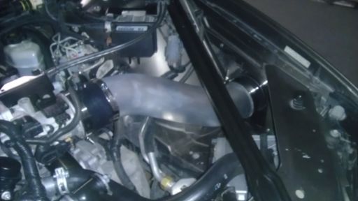

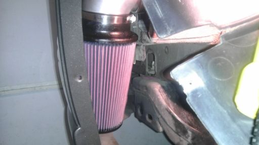

I finished the FWI:
http://i491.photobucket.com/albums/r...ps93cd39e2.jpg
http://i491.photobucket.com/albums/r...psf6339590.jpg
Just need to secure the PCM.
