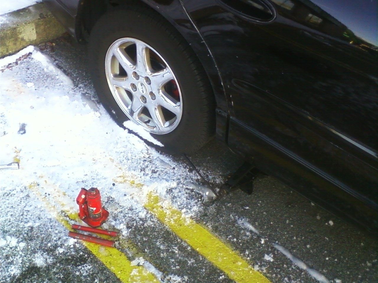

BOOO. now this is how you start of your day.
http://i1097.photobucket.com/albums/...sc38b62c2.jpeg
so had to dig out my trunk, aka unload it, drag out the spare tire. the bottle jack didn't fit so i had to use the stock jack to get the tire off, yea me!!! then i took it to my friends pumped it up to 60 psi, hit it with a spray bottle of hot soapy water. found the inside bead leaking the whole way round.
beat the tire off the bead some, installed bead sealant, so far so good, passed the bubble test back at 60 psi.
