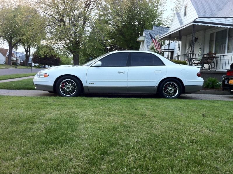

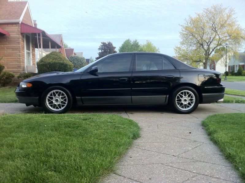

  19. #59 Re: Nitrous kit or suspension??
    Buffalo
    3,868
  20. #60 Re: Nitrous kit or suspension??
    Buffalo
    3,868
    The white gsx didn't use rear DNA or intrigue springs
