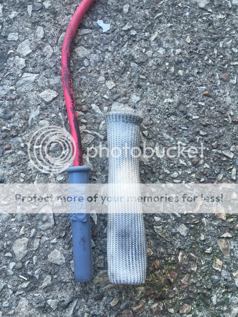

    So I had turned my back on MSD wires for a set of ZZP 10.5 wires....
    all because I kept somehow burning up wire #4 and I'm talking the multi angled msds for our cars....I could have clipped them better yea its true
    But just when I'm like these MSD are the devil ....I get these ZZP wires and mannnnnnnnnn .....ive read it before they burn on headers .....
    but those were the straight boot zzp wires......well I'm hear to tell u so do the new ones 2.....there just not long enough (the boots) ...
    They're angled but that angle stops right at the middle of the headers .....and are so close, one slight bounce and they're BBQ.....I clipped the up but I tell u.....
    ur safe on #2 all the way, #1 the second safest, #3 third safe but needs secure clipping ......the rest are on skillet cause of the way my headers shaped(pacesetters) ..
    #5 #6 have the same angled problem .....#4 is doomed period its gotta sit on the headers ....3 days and them joints had my car misfiring I'm like sh****t .....
    I even tried putting DEI boot sleeves on them ..these wires are sooo close to the header that the boot sleeves acted as a bridge and were helping further teriyaki chicken and shrimp no veggie extra chicken them thangss
    ....so now I can see the wire ....HORRIBLE!!!!
    it took my MSD with no clipping just angle them off prolly like 10 months to cook a hole in just one boot ....
    but I felt the stronger spark in ZZP 10.5s ...my car picked up a lil better than MSDs did brand new out the box...
    SO my ?? is HAS ANYONE EVER FAB SOME MSD TERMINALS ONTO THE ZZP 10.5 WIRES WITH SUCCESS???????????
    would love to get the best outta both like they do with taylor wires

    No I have not tried that nor would I. MSD are 8.5 and ZZP are 10.5. I've had both and hated the ZZP wires. They don't fit correctly. The msd wires fit but have misfire issues like the ZZP ones. Why don't you get spark plug boot protectors made for this issue??

    never had a problem with the msd 8.5 wire sets. get the universal MSD V8 kit with the bendable boots for "hei" it gives you the tool to crimp em to length, and the plug end is made to bend the terminal real close to the end of plug I have over an inch of air gap between the PS #4 and the plug, boot, no protectors, been remived about 80 times.
    best part is the two extra wires in the kit can be terminated to the same length as your longest one and tossed on the wall for spares/testing along with the two extra terminals (meant for the coil to dizzy wire) so you can shorten them down to replace a bad wire.
    ive been testing the Mallory 14mm wires on my daily for years, never had a problem, ive replaced/found bad wires/terminals on 3 different cars with zzp/taylor wires

    all zzp (1st/2nd/3rd gen/batches) I had to screw with (to be fair ive seen two sets with never an issue) had terminal issueswhich led to arcing, which led to never being fixed even re crimping the end spring
    the MSD kits /plug terminals are nice, the bendable kit has long sturdy be kinked necks between the wire/sheath/center conductor crimp and the plug end, the thing has a stainless tension spring wrapped around the terminal with nice pronounced dimples. you just have to make sure the gap on the plug terminal is towards the inside of the direction you intend to bent the boot/terminal to clear #4, the boot msd label is rarely indexed perfectly so look for the gap.
    their site has more info, get a tube of AGS sil-glyde
    its a godsend for perfect crimps with the tool/vice, and youlll want it for the boots when you put em on the coils/plugs, they will easlily twist off even after 2 years of cooking in place, you wont even have to wiggle em (which is bad mkay) if you do the twist a gentle slight conical motion can get a stubborn one off
    always let the wires curl naturally when you can, first parts off/last on during service work (I do this with the 3 perfect/minty blue coils on the TR) and always let em sit in a nice large arc.
    these rules will extend any wire set, but seriously the TR wire set has been removed about 200 times, including for the 11million times we've broken the trans and yanked the engine then the trans from above.
