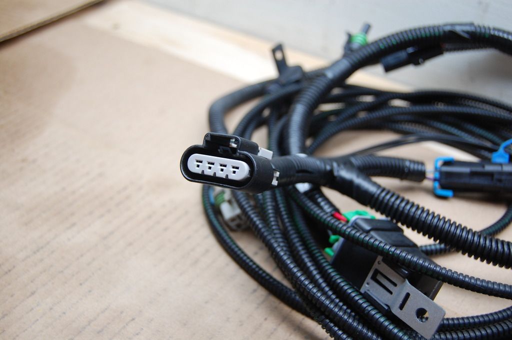

  6. #26 Re: Does my car have a venturi fuel pump?
    Mar 2014
    Tucson
    3,192
    10
    146
    Quote Originally Posted by industrialfish View Post
    Discovered my canister is a different plug than the Casper harness
    I modified my Casper harness with a spare pigtail I had:
    I don't know why they still sell them with that square plug. They've bee doing that flat four plug for how long now?
  7. #27 Re: Does my car have a venturi fuel pump?
    Oct 2011
    Toledo, OH
    1,251
    Fortunately I have a pair of the square plugs sitting here so I can convert my canister and harness. It was getting late and I need the car in the morning so I didn't take the plunge in cutting things up yet.
