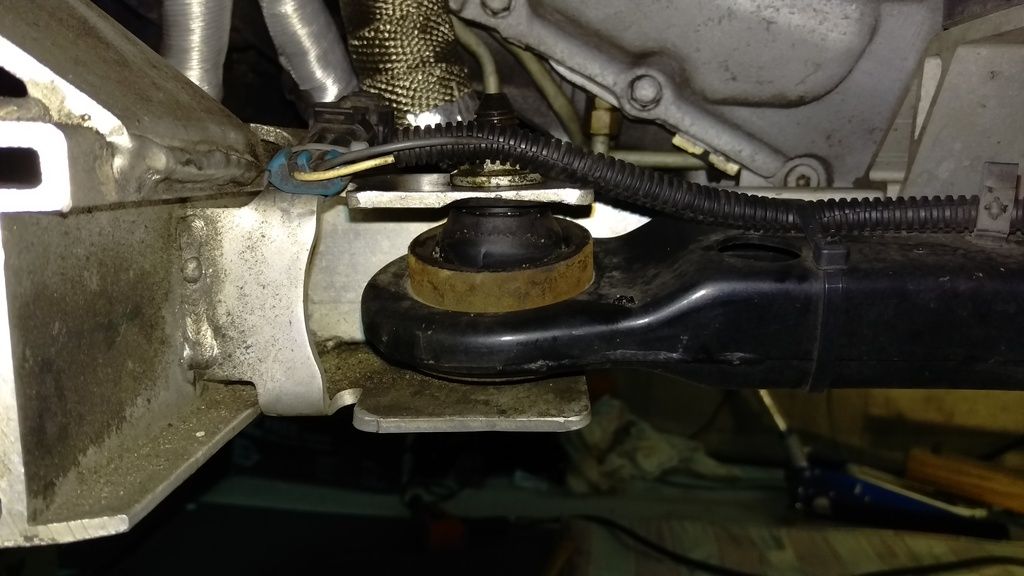

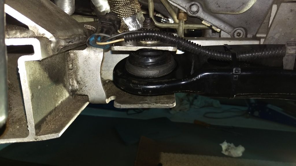

    Passing this along on here as well. But the Moog LCA's do not come with these bushings. These are the CK series that I have. one bushing was actually installed incorrectly from Moog.
    These are the problem solving bushings pressed into the Moog LCA
    These bushings are night and day. Much more responsive than the rubber bushing.

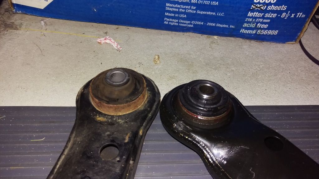

    What is the diameter (in MM) of these bushings? I want to adapt them to my car and Moog does not list it. Mine are 60.4mm on one side and 70.4 on the other.. mine are shot...

    :facepalm: the moog bushing are not installed wrong from the factory... They use the same stamping for both left and right sides, so the bushing only goes in ONE way, so it's flipped on one of them. It's the same on OEM and Dorman LCA's

    Mine weren't, they were both lip side down. When they were installed upside down (by me, I thought it didn't matter and I noticed after I was done with the job), the driver side began to pull out.

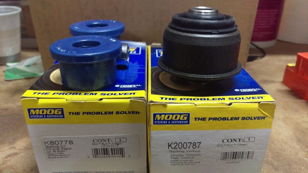

    More importantly is this the bushing to replace the other one ?
    inbeen looking for that bushing in poly but cannot find it or cross reference it
  20. #100 Re: Massive inprovement in front end feel for 50$
    Buffalo
    3,868
    F this forum lol i copy and pasted exactly what you had posted and it will not show up.
    I'm referring to bushing K80778
