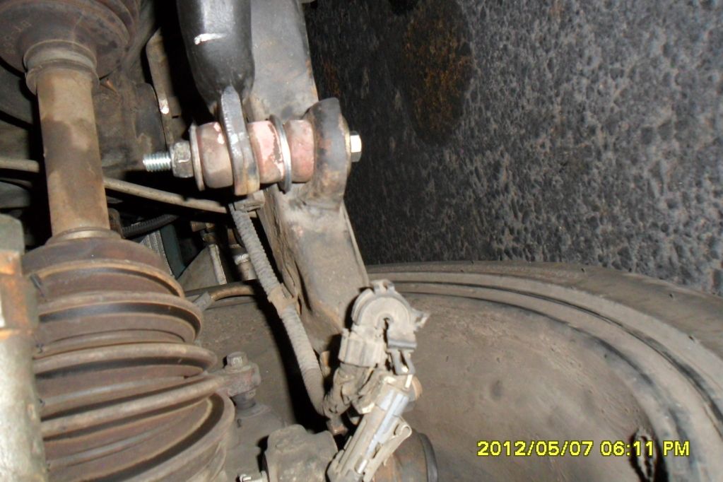

    I was one of the guys on there that did this mod I was on SSC\AGX combo on my 97 GP and had tire wander problems and other issues with my suspension. And yes i had it aligned 5 freakin times till i got creative and tried this out...fixed my problems immediatley! all i did was get sway bar bushings (poly) from autozone get a grade 8 bolt from lowes and installed
    pics And excuse the the dirt....**** u arizona lol
  4. #4 Re: Anyone with lowering springs..........did you change out your sway bar end links!
    only things i found with measurements...
    Quote Originally Posted by gtpforever
    The bolts in my kit are about 4" in length to the bottom of the head of the bolt or right around there. But mine is a farnsworth kit.
    Quote Originally Posted by firefightergtp (our copgtp)
    Well, I needed a new bolt for my passenger side bc it stripped. I went ahead and got some 5" bolts and put 4 washers in place of the spacer. Its about 1/3 the size of the spacer.
    and a reaction from copper:
    So I went ahead and tried this mod out.........and I have to say it makes a HUGE difference!!! I was skeptical at first, but keeping that sway bar level really helps.
    The car feels much better on the road now, doesn't feel as "touchy", and I don't get that wondering feeling either. I'm lowered on SSC springs and AGX struts, FWIW.
    I went with a 5" grade 8 bolt, and 4 washers.
