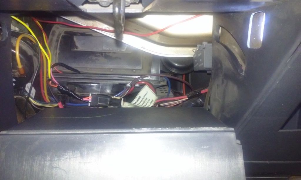

    I used a power drop harness to grab fused, keyed power. It's the unused plug hidden behind the glove box.

    Literally directly behind the glove box.
    Drop the glove box past the stops, and look for a white warning tag.

    Okay I found the plug under my glove box and just ordered the drop down harness from zzp there's no slack to really splice in I'd rather do it the right way. The aeroforce gauge instructions say hook the red wire to an acessory wire the other 2 wires on the plug for the aeroforce are for analog inputs. So on the zzp harness the 3 wires one is constant power, another is acessory power, and then a ground wire?
