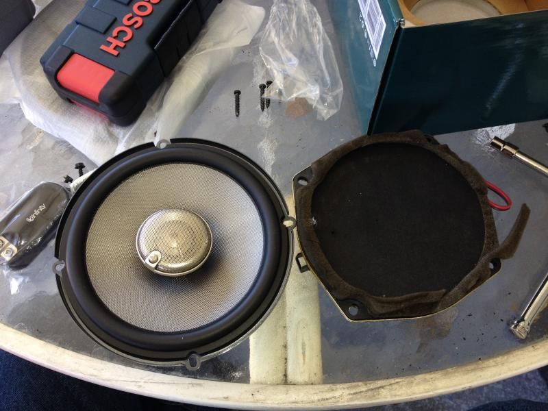

    Differences between the OEM and Infinity Kappas. Slight upgrade in quality:

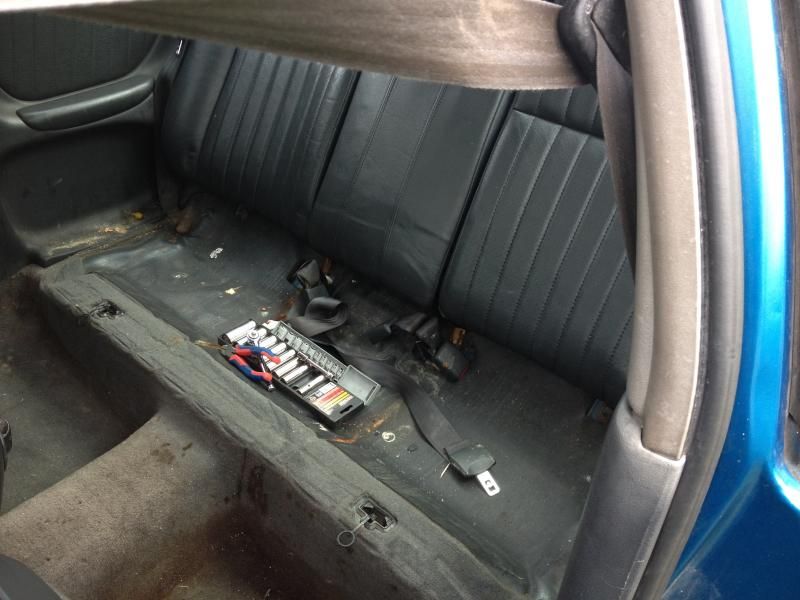

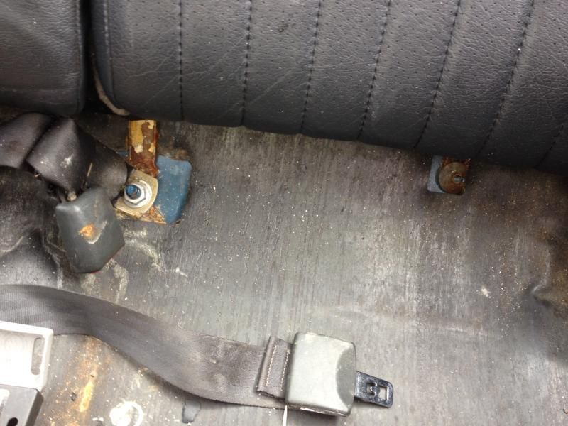

    For the rears, take the lower seat bottom out.
    Then you have 4 nuts to remove from the seat backrest ( Two on each side ). You will need a 10mm and 18mm socket for this.

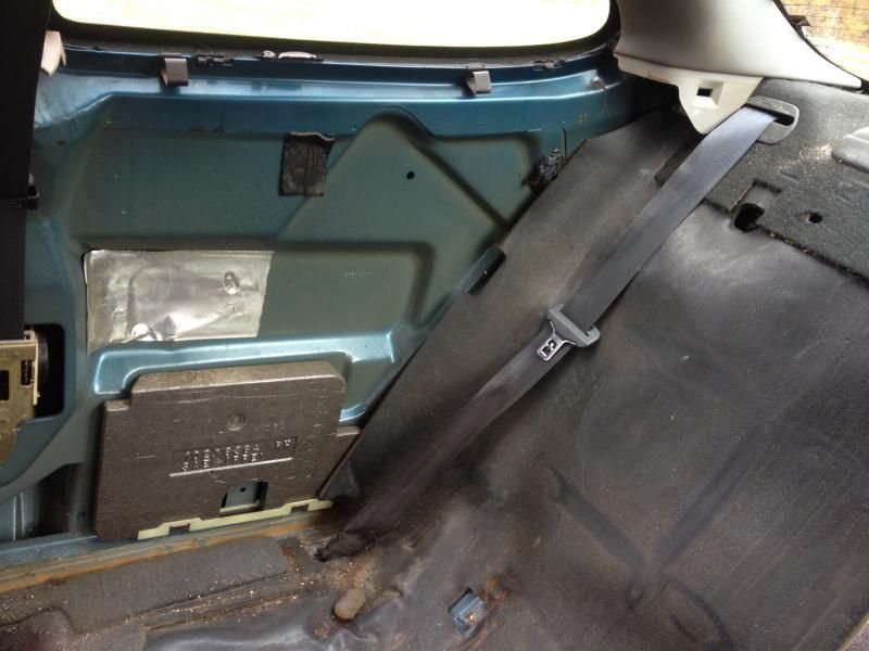

    Remove both inner side panels. These just pop in and out. You do not need to remove the door sill molding. They will slide in and out with no problems:

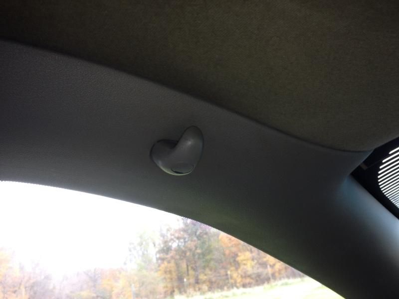

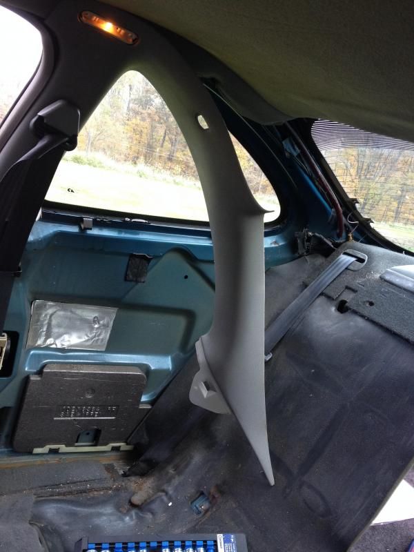

    Next, remove the clothes hanger brackets from the C-Pillar moldings. They just pop out with a flat blade screwdriver:
    Next, pop the rear of the C-Pillar molding loose and wrap around and down to where it touches the back of the seat rest support. It will stay in place and give you plenty of room. You do not need to remove the molding:

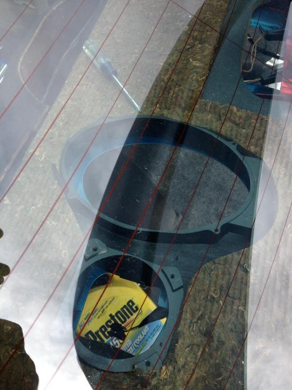

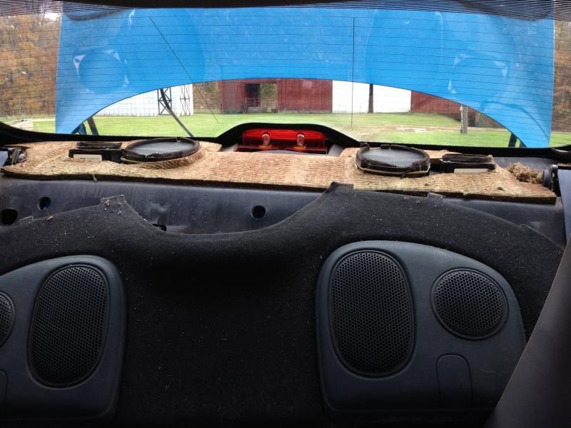

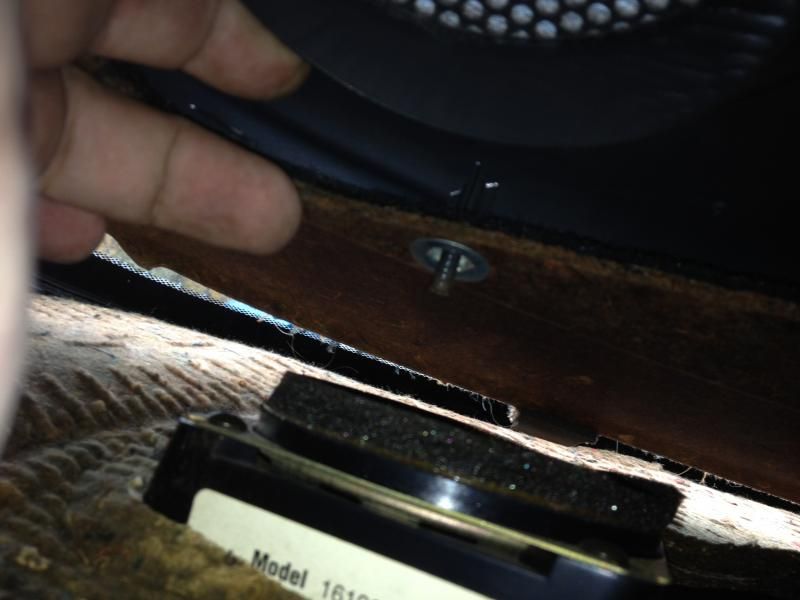

    There are 2 black plastic lock tabs that need to be removed form the rear deck cover. Once those are removed, lift up on the cover and pull it forward. If it doesn't come forward, you aren't lifting up on it enough. There are bolts on the bottom of the cover that catches the speakers. You have to clear those:

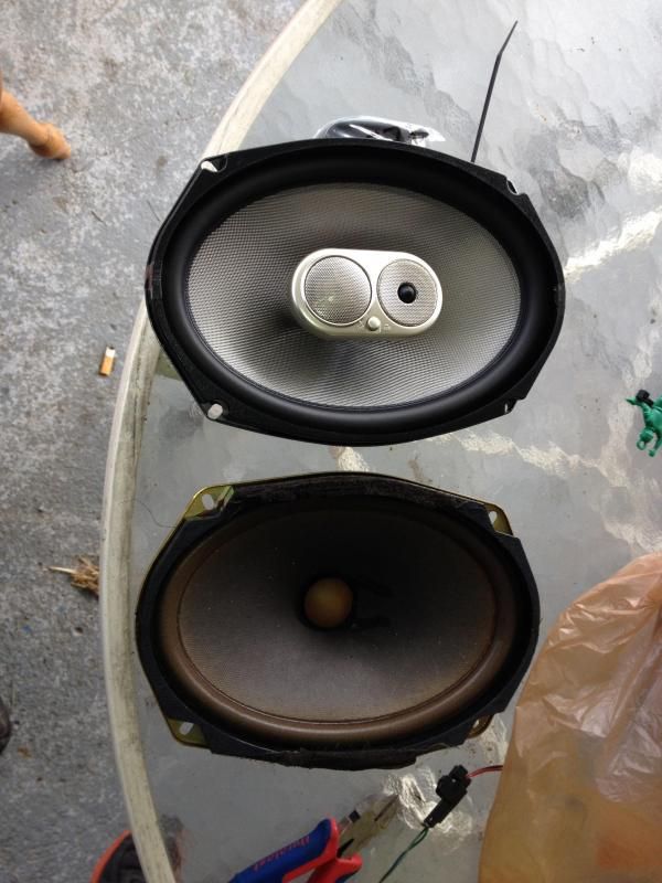

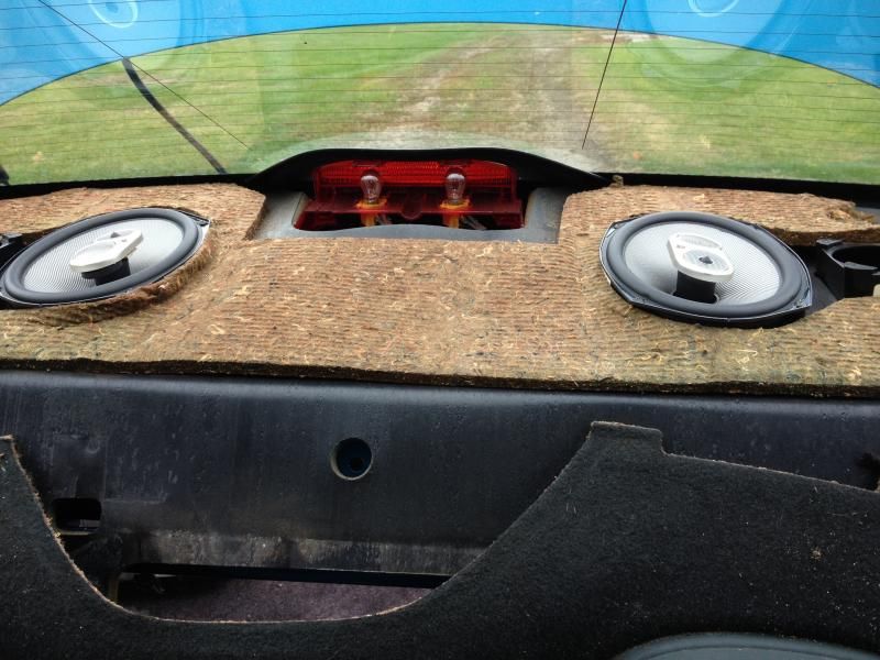

    Once this is done, you just remove the speakers. I took out the 4" speakers as they are completely useless......plus, in theory, I may grab a little extra bass from the trunk this way.......and the weight saving of leaving those 4" speakers out means I will probably pick up a couple tenths in the 1/4 mile:
    Here it is with the new 6x9's in place. I aimed the horns to the outer edges as in theory, it will help the highs wrap through the car rather than just be focused into the center of the car.

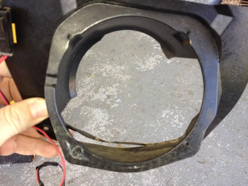

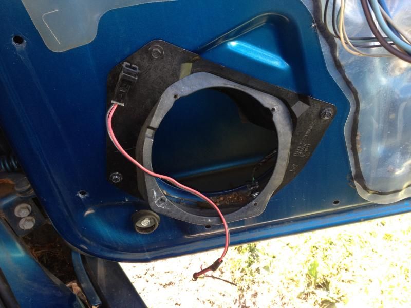

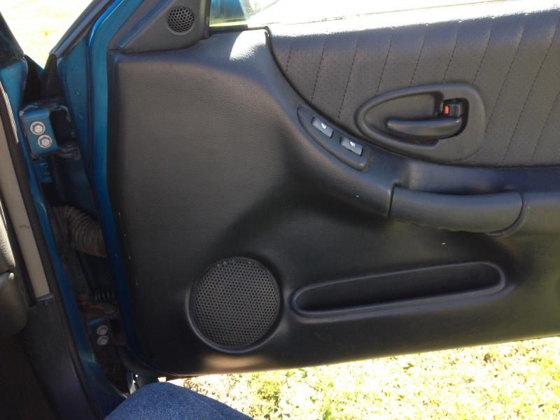

    For the fronts, Remove the door panels. It also would be smart if you have some new nylon panel tabs to replace the ones you are going to break or strip when you pull the doors off. You will want to remove the speaker and speaker mount.
    If you drop the bigger aftermarket speaker in the mount, as you guessed, the results are expected.

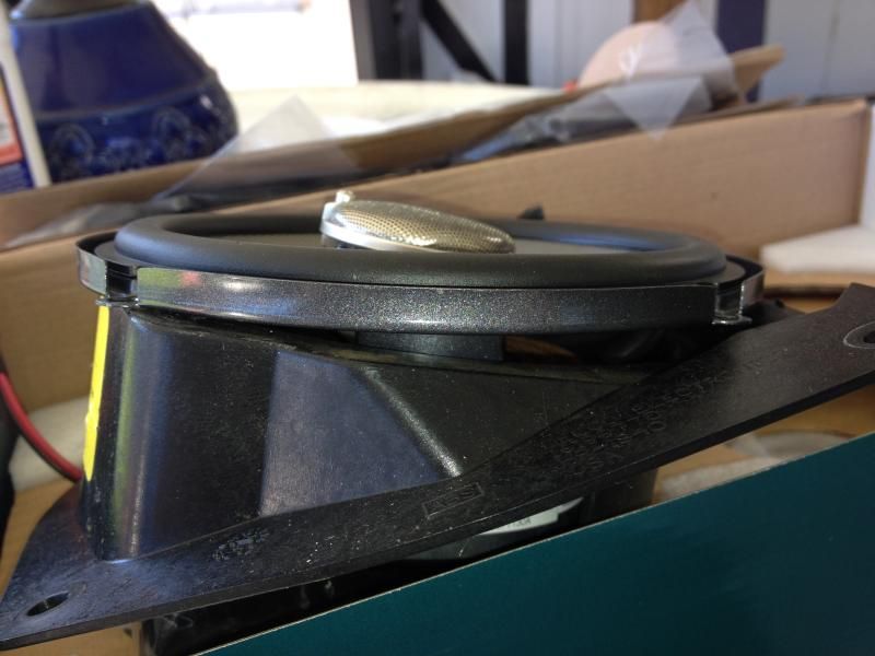

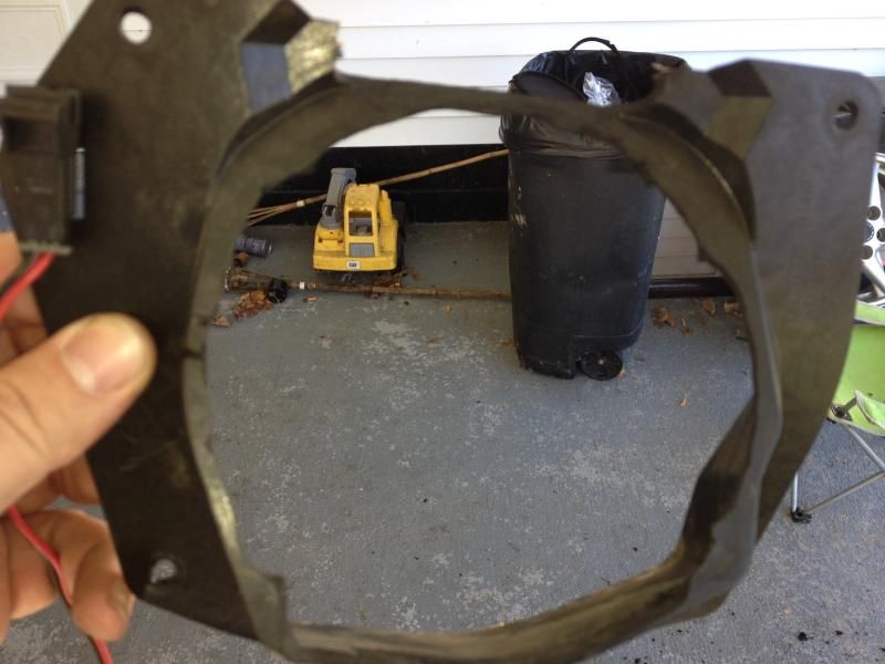

    Front of speaker mount before modification:
    This is everything I had to remove to make the speaker fit flush:

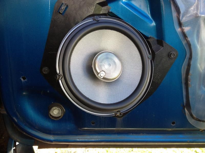

    This fits with perfection. The edge of the speaker just touches the support shelf on the door. The only way to move the speaker higher would be to remove metal from the door.
    The bottom two mounting holes on the speaker extend beyond the mounting surface of the speaker mount. This is an easy fix.....bend the tabs over the edge and run your mounting screws in. If you position it just right, it will be a flush fit. If not, just angle the screw away from the speaker slightly and it will pull flush and be extremely rigid:[

    You did a lot of extra work do get to the 6x9s, you dont have to remove anything except the rear seat and the rear deck cover. So you didn't have to remove the rear side panels or the c pillar.
