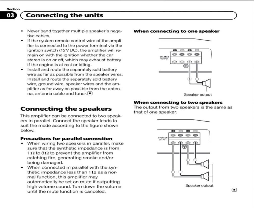

    Now another thing is that the subs have a dual voice cone meaning it has 4 jacks to hook into. I started poking around the internet on what I would do to hook them up using Rockford Fosgates wiring diagrams and other wiring diagrams and noticed that by running them differently you can change the resistance (ohms). Then now instead of needing a 4ohm amp you can use a 1ohm. Now Im beginning to second guess myself some more. And how many ohms is it per set of jacks? Any upsides to running a certain number of ohms over another. (Ive read the higher the ohms the better the clarity)
