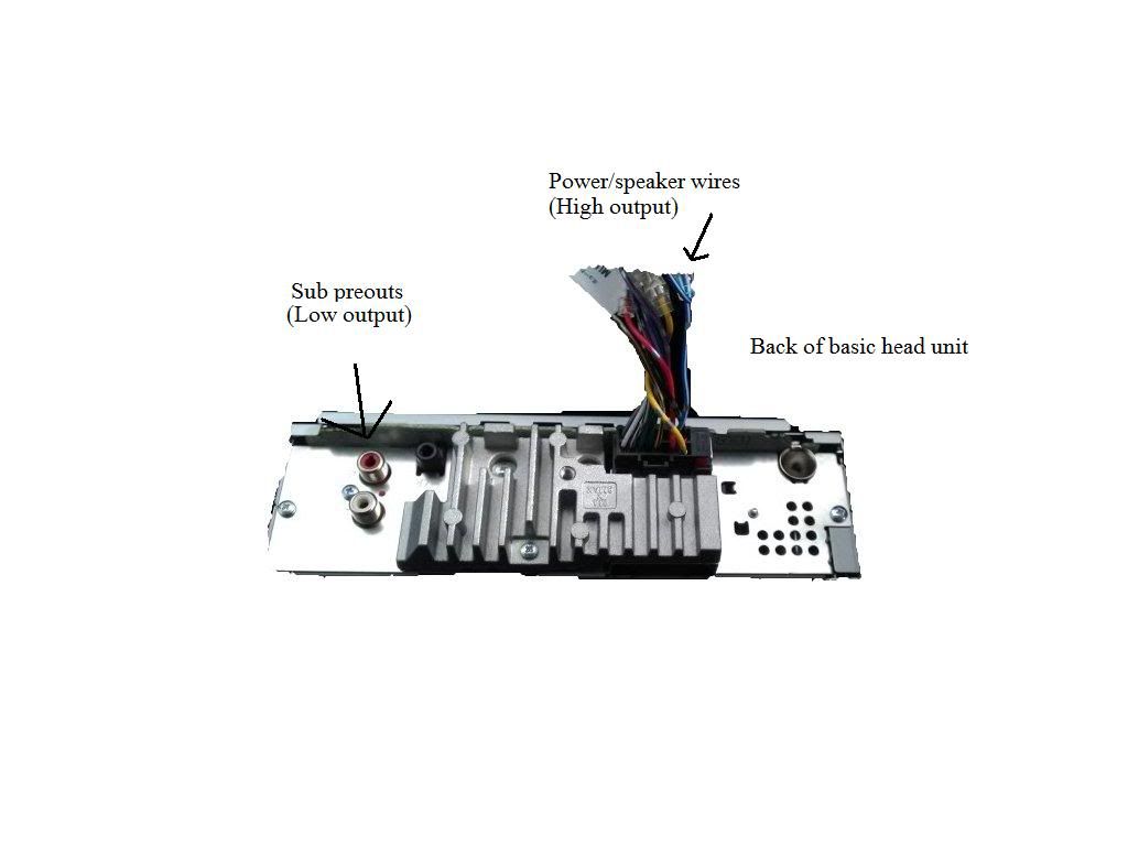

    If you're just wanting to cut the high input plug and splice in rca ends...dont. Then you'd be plugging a high level signal into a low level input. If you wanted to go that route, just add a line out converter and that will change from high input to low. But you'll still not have any sub control through your HU. Just get about 25' of rca's and that will be plenty to run from your sub preouts on your HU, down either side of the car and to your amp inputs. Then you can use your subwoofer control to adjust the subs.

    Wrong. You will be sending a high level signal to a low level input. You need a step down converter (line out converter) to do that. It will step down the high level to low level. But you might as well leave it be if you're going to do that. You wont notice any difference. To get sub control from your HU, you need to connect rca's from the sub preouts on the back of the HU to the rca input on the amp.

    Not sure you're understanding. The sub preouts on the headunit are completely independent from the speaker wires. You would disconnect the High input plug from your amp (you dont even have to disconnect the high input harness from the speaker wires if you don't want to). And plug rca's into the subwoofer preouts on the radio, to the rca inputs on the amp. That is how the amp gets it's signal, from the rca's. The way it is now, it is getting it's signal from the speaker wires.
