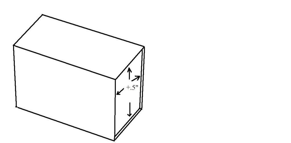

    Hows that look?

    One thing I like to do when making an enclosure is to make my facia, rear, top and bottom boards about 1" longer than they need to be. Then recess both side boards in .5". This lip will give you something to grab onto when you need to pick up the box, move it around, etc. It actually makes it easier to carpet as well.

    Me likey. I will do that for sure.
