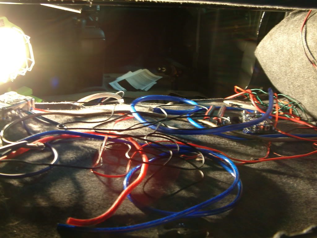

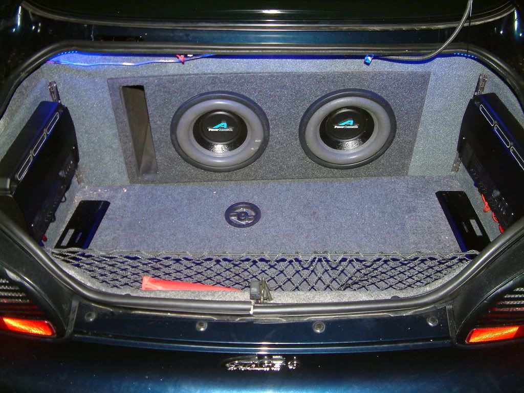

    Man what a day, started at 9am and finished a little after 11pm. I took my time on the electrical stuff, I didnt want to ruin any of my amps or stuff. But I think it came out quite well. Kevin stopped by for a little to help with the initial stuff and then had to leave on account his father was admitted to the hosiptal.
    Anyways I think it came out quite well. Unfortuately on one of my ground 4ga cables I had to use a red power one cause I didnt have sufficent length of silver cable to complete the job, so it worked in a pinch. I just wanted everything color coordinated.
    The SoundStream PowerPlant is a neat unit, I ran my 1/0ga wire from the batter to the unit. And it has 4 80amp fuses on it, my Power Distribution Block is a Kanutz Concepts 3 fused relay, it holds 3 40amp fuses as the main breaking point in the power chain. The design is suppose to allow for better and more equal current to pass through the line. And then PowerPlant just distributes the power evenly across all amps. Plus its 80amp fuses act as a backup incase something bad happens.
    I have now two Kenwood Amps, KAC-X4C and the X1R. The X1R, the bass amp, is running at 2ohms for 1,200 watts between my two Power Acountics, which splits even around 600rms each sub, and then X4C is pushing 75watts x4 at 4ohms.
    Enough jabbering...........Here are some of the pictures I took during the installation.

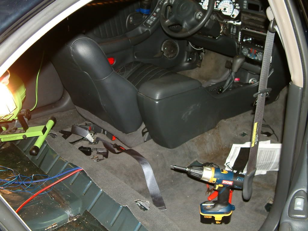

    Tore out the chair and the carpet to lay the new Monster Performance RCA cables, I love those things!!

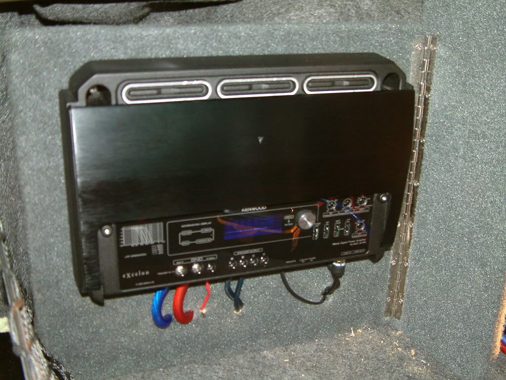

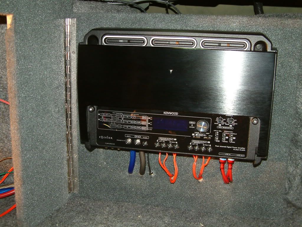

    This is the Kenwood 4 Channel Amp
    This is the Kenwood Sub Amp
    I was very anal about getting the wiring setup very nicely to make it look pretty clean

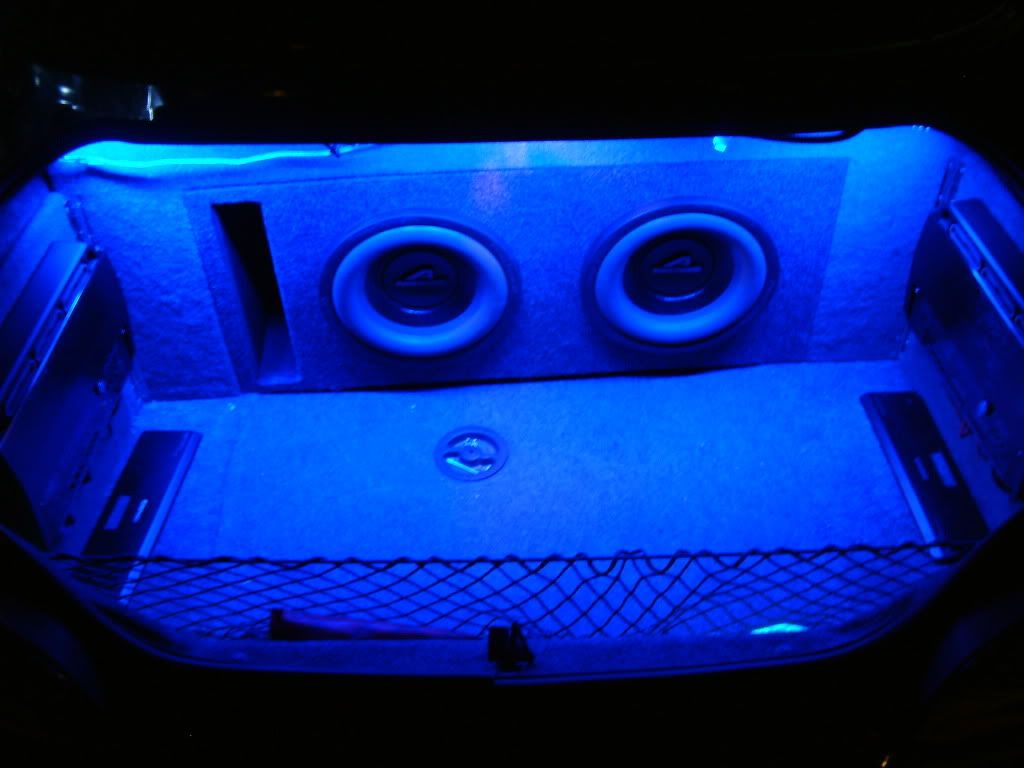

    Now for the final masterpiece, the completed trunk with all subs, amps and cabling down.

    Next up is the SoundStream Power Plant. This thing is made super heavy duty!
    This was the mock up I did for the pass thru section of the rear seat. I cut a 15x13 1/4" piece of MDF board and attached it to the bottom section of the upper deck, there were three holes in the sheet metal I was able to put three screws through to secure MDF board in place. I think it worked out. I have to still take some pictures with the seat back in place to show you how it looks.
    And you see my location I made for my 1/0ga ground wire. I used an adjusting drill bit, cause you are drilling right near the gas tank. I then sanded away all the paint to expose the bare metal beneath, I think would qualify as a good ground
    I really loved how the whole pass thru and PowerPlant worked out.
    Needless to say its bright, it lights up the inside of the car pretty good, I almost have to keep the rear middle pass thru closed at night
    Here are some other pictures of the trunk area.

    Here are some daylight photos of the trunk again and the passthru with the rear seat fully installed. The wiring is not as clean as I would like it, but I will later on the future when I get my silver 4ga StreetWires to replace the not so color coordinated wires in there currently. The 1/0ga wires are hard to rearrange, so they are gonna stay where they are, but the Remote wires and the 4ga wires will be tucked in behind the pass through wall into the PowerPlant to give it a much cleaner look.
    And the pass through closes up perfectly without any interferance from the PowerPlant.
    Here is one thing I forgot to photograph as well. The 1/0 Kuntz Concepts 3 ANL Mini fuse distribution block. I love this thing!
