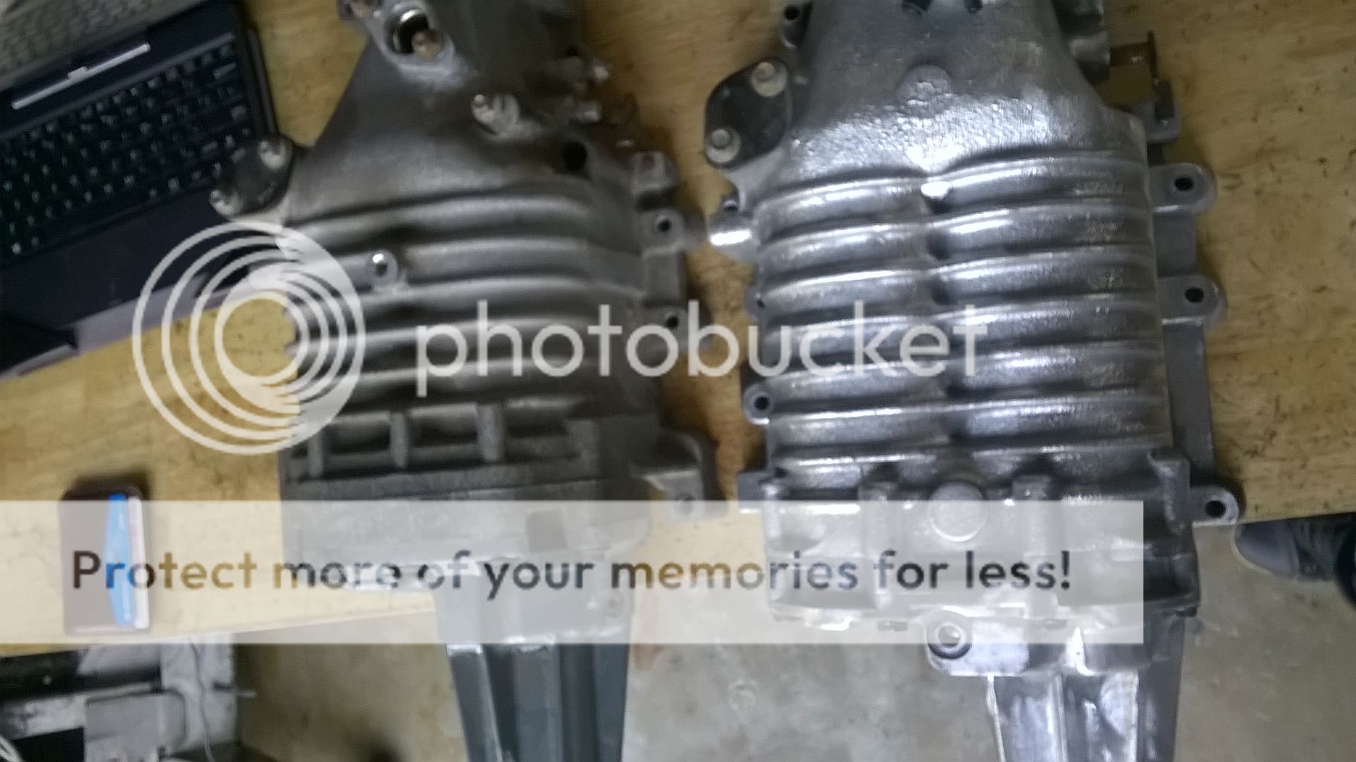

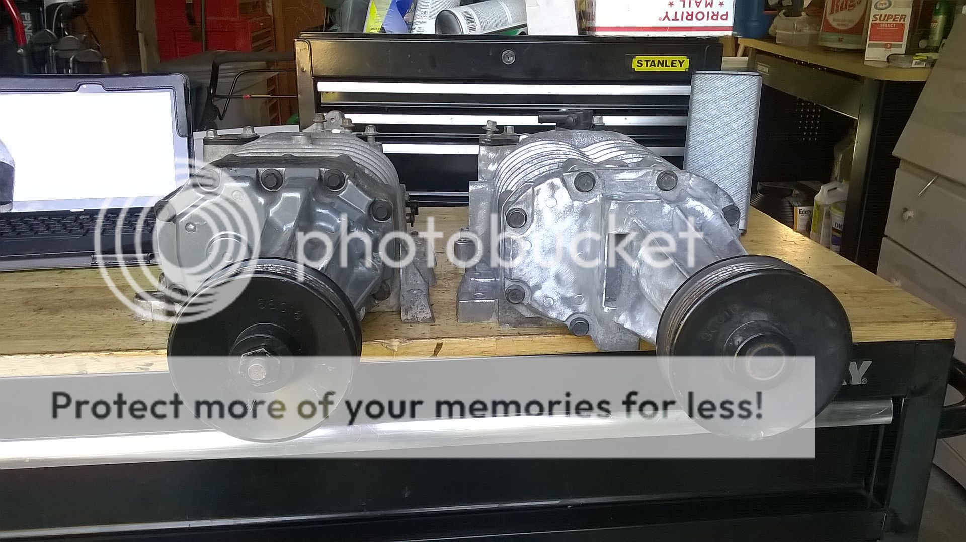

    long story short, ive been planning on running a gen4 hybrid blower setup. which i THOUGHT was take a ported gen3 case with gen5 rotors and boom gen4.
    but until today i never had my two blowers side by side.
    and as you can tell, the rotors mount up similarly, but aren't exact. i would really like to make the gen4 thing work considering i don't have the gen5 LIM and i really would rather not redo my perfectly good LIM gaskets.
    i really want to make this gen4 thing work, so
    anyone with any knowledge of this is welcomed!

    you just install it using a Gen 5 blower gasket and run an adapter to use a drive by cable throttle body on the 4 wheel drive by wire flange

  6. #6 Re: Gen4 hybrid blower questions
    hangover park IL
    2,714
    11
    the bolt pattern is identical the opening is just shifted towards the snout almost seven eighths of an inch headset you can cut open the intake or you can just put it on and ignore it and be perfectly fine. plenty of guys put gen5 blowers on top of Gen III intercoolers

    so of a bittch. so i can just run that blower no problem.
    why didnt anyone tell me this before i just traded my adapter plate
  8. #8 Re: Gen4 hybrid blower questions
    pretty much.
