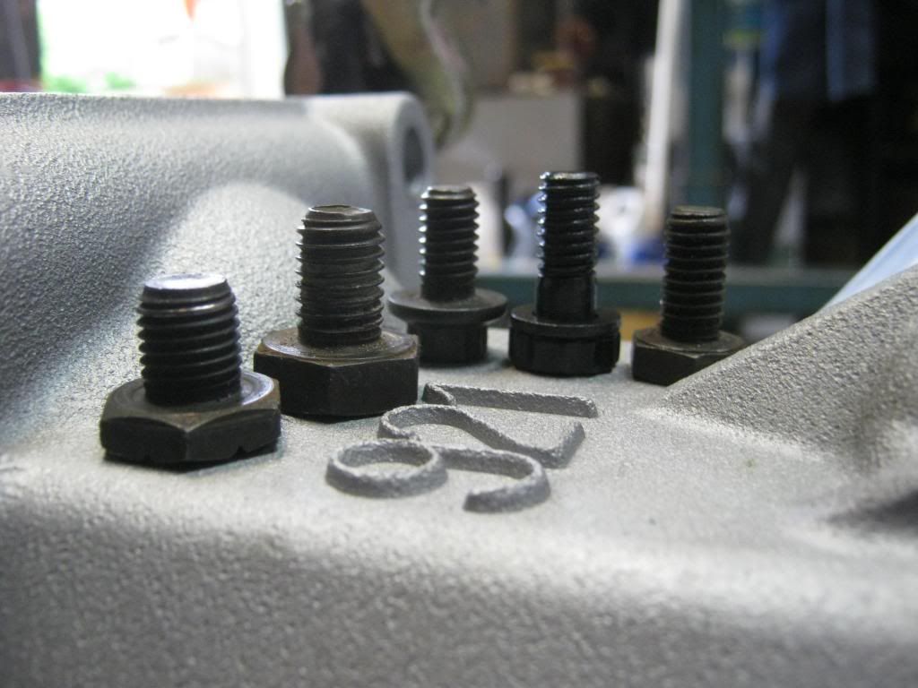

    counterbore yer crank bolt holes to 5/16ths at 3/16ths deep (cheap HF step drill works great, file down the sharp edge of the 1/4" step so it wont cut away your threads) and use the arp ford (clutch) pressure plate bolts to bolt it to the crank, much nicer and better than the std 5/16ths arp bolts.
    two on the left are the precision m10x1.0 converter bolts and the OEM m10x1.5
    the three on the right are the "std" small 3/8ths hex/12point arp 5/16ths bolts offered by venders, to the right of it is the ARP ford pressure late bolts with 1/2" 12 point head, large underhead dia, longer shank length, and the OEM flexplate to crank bolt on the right
