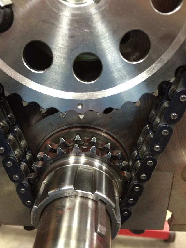

    Putting my double roller on. Does the crank gear need to be hit onto the crank? The stock one slid off with my hand. The DR crank sproket seems like it barley fits and needs to be hit on with a big socket. Also, I line up the 0 marks on the gear as well so the 0 is facing up and the dot on the cam gear is facing down and lining up with the 0 correct? My crank gear was also machined to match the stock one.
    Thanks.

    Yep and yep

    Perfect..thank you!
