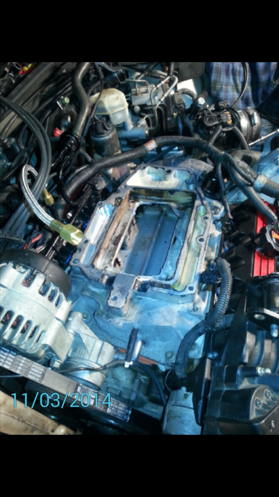

    So i wanted to redo my setup and pull the supercharger off from the intercooler and re rtv it. sounds simple right? I thought so. Just ten bolts, and pry up and it should come out. I could not for the life of me get it to budge. Then i tried pry bars under the snout. i got nothing, i finally got a pry bar and big ass hammer and kept beating on it. Here is the result. Now i have TWO problems.

    Just did this last week had to finagle a big pry bar between the core and s/c / intake working all sides. Eventually they came apart.

    I got it! I just need to know how to put the top of the intercooler back on without taking the bottom off of the LIM. Is there a diagram of where rtv goes?

    how the hell does that even happen? did you follow this at all when you installed it? http://www.grandprixforums.net/threa...BS-Intercooler

    Yes. read the top of the post. I was taking it apart, this is how it came apart. I should of used a pry bar between sc and ic and it would of came apart the way i wanted to . I basically just need to figure out how to put the intercooler back together now and where the rtv goes.

    "I could not for the life of me get it to budge. Then i tried pry barsunder the snout. i got nothing, i finally got a pry barand big ass hammer and kept beating on it."
