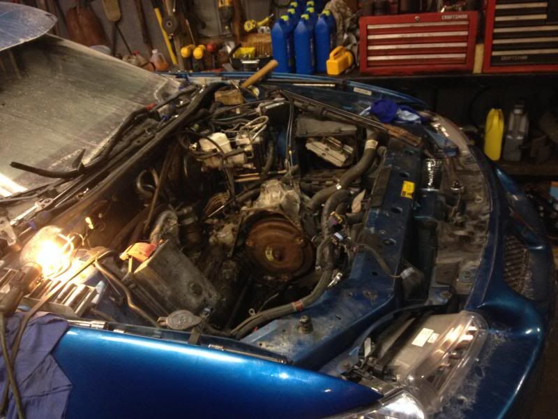

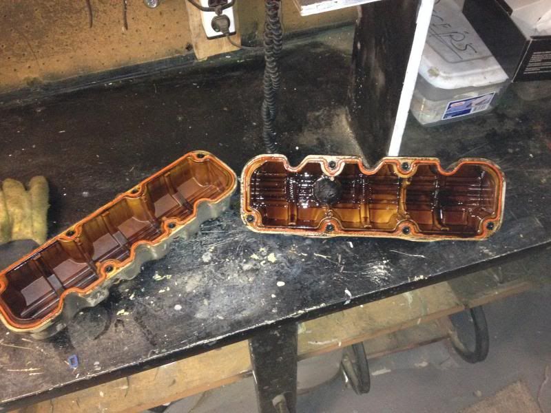

    Well, its not a full tear down. It is a 72K $250 junkyard engine. With the exception of the head gaskets and valve stem seals, every other gasket and seal is getting replaced. Whoever had this engine really took care of it as there is no sludge or buildup in the engine at all. No metal particles in the oil pan. Remote snake cam shows excellent hashing on the cylinder walls and not chips on the pistons.
    In case you have never removed a harmonic balancer from one of these, they are very difficult. GM put some sort of reddish-orange sealant/thread locker on the bolt. It kind of looks like the stuff they used to seal the snout up to the supercharger. You can make a tool that locks the balancer in place by using a couple of the 3 slots on the balancer and locking it up against something, or, you can do what I did.... a 1" impact running 175 p.s.i. A 3/4" on 175 p.s.i. wouldn't even budge it. When I say " I ", I mean my garage monkey. I re-broke my arms where steel plates and screws are and can not do anything. So, I found someone that was willing to help, listen and learn to do the wrench turning.

    the first pic. you always need a BFH when doing a tear down lol
    looks clean. it just getting new gaskets, or a few more fun parts?

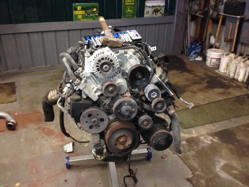

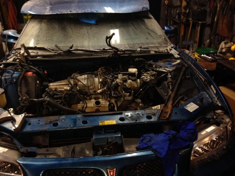

    Well, last two days have been working on the car. I realized why I quit working off the ground years ago. Getting too old for this $hit. I used eBay headers and while they seem like a nice pair, the top bolt on the 2-1 flange where the headers come together is a pain in the ass to get to. I had to use a few extensions linked together and go at it from the top.
    I broke a rocker bolt. About cried as I figured finding one for it would be impossible without making a 3 hour round trip to Jegs. Fortunately, my local hardware store had them in stock and made by the same company....completely identical.
    Got the engine out here:

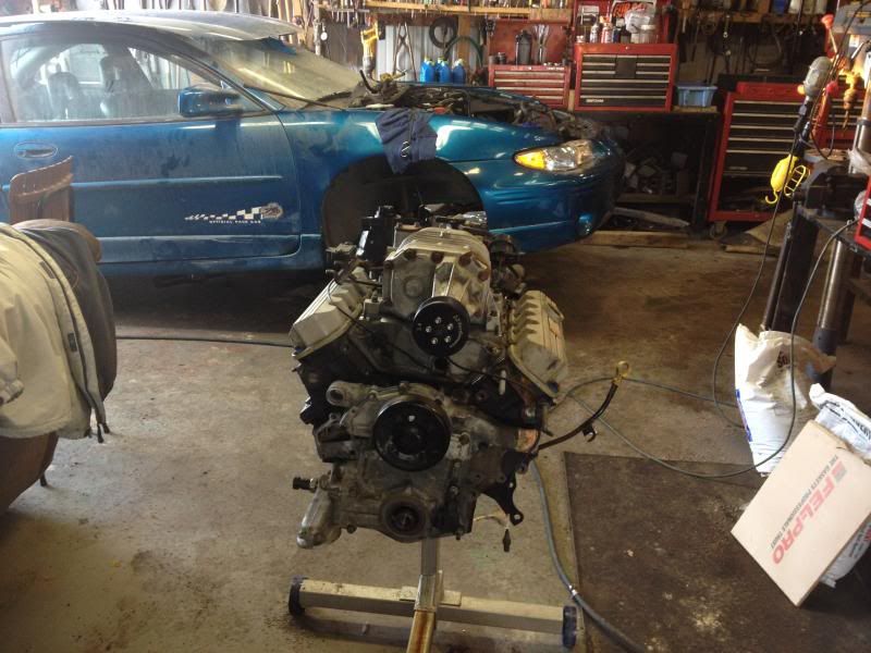

    Yes, I took the rear exhaust and flange out at the same time. It seems easier this way:

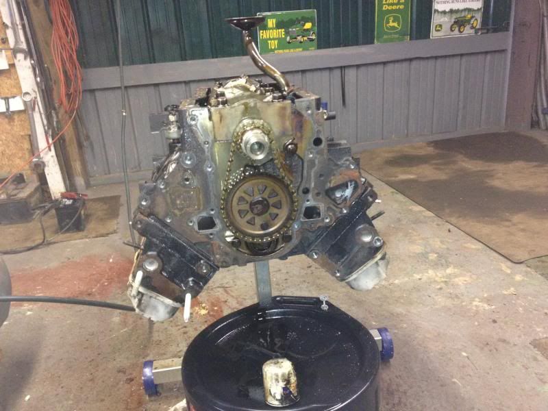

    This is the back of the old engine. Notice the flywheel bolts are broken off in it. I was only doing about 35MPH when this happened. It is just that the engine scattering was so severe.

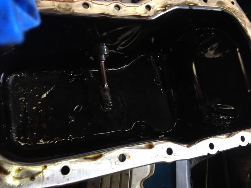

    This is the inside of the oil pan. Its hard to make out, but, there was half of a rod cap, a couple bolts and tons of metal shavings. I cleaned all that out andput the metal shavings back in as I figured they would just help the new engine by joining existing parts and making them stronger :P/.

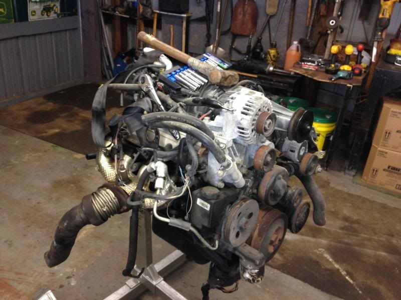

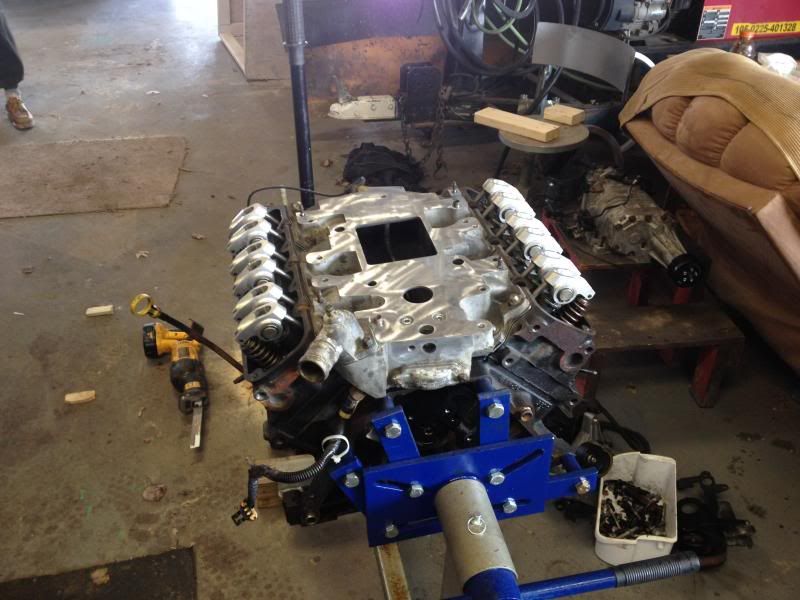

    Putting some parts onto the replacement engine:
    Little bit closer:
    Engine settled into the engine bay. I went in much easier than I anticipated as installs usually are a pain. This is where I stopped at for this evening. Will go back tomorrow and hopefully get at least everything underneath the car done. With gracious amounts of good luck, may even get to start it up.
