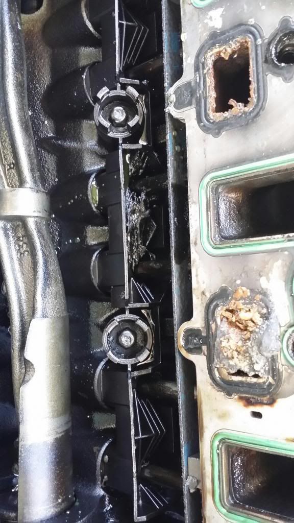

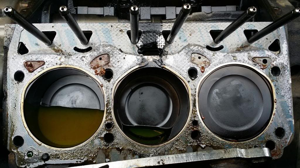

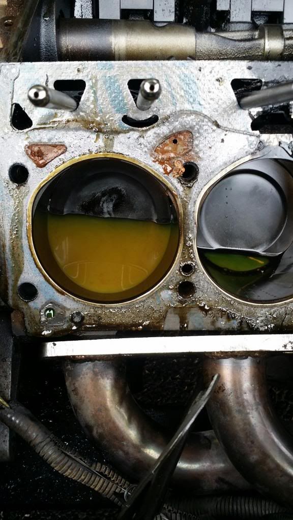

So the little scope I got was too big for the spark plug hole. I finally was able to do a compression test and the cylinder with the messed up spark plug was at 120. Tested it 4 times to be sure and 120 each time. A guy I know said it's not a piston or ring if it's that high. He said it's going to be the valve. Do you guys think that could be the problem?? I was thinking of breaking it down tomorrow and popping off the head to take a look. Any directions to a good write up on removing heads??
http://i1322.photobucket.com/albums/...ps1ab53018.jpghttp://i1322.photobucket.com/albums/...ps9e408f86.jpghttp://i1322.photobucket.com/albums/...ps81799e01.jpghttp://i1322.photobucket.com/albums/...ps023abbd9.jpg
http://i1322.photobucket.com/albums/...psddd140d9.jpghttp://i1322.photobucket.com/albums/...ps818a403a.jpg
Where should I go from here???????
