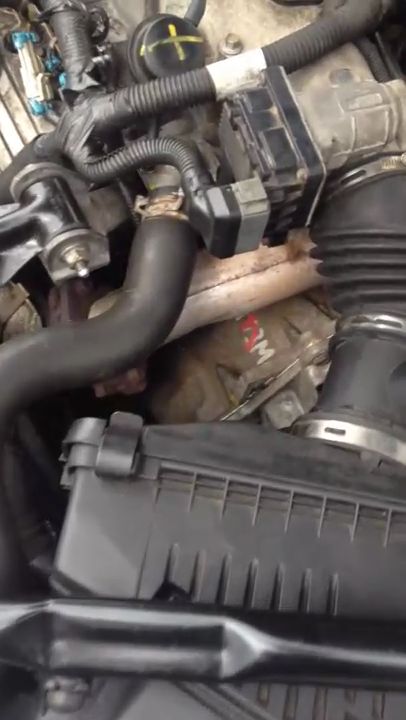

    Ok I've Been completed this Job but I've had one problem since then, this vac leak, it doesn't seem to effect the idle or drive in any way but the problem is that I can't pinpoint it. it's somewhere below the throttle body near the bottom of the intake and it's not the air box or related as far as I know, and since the cars been down because of a broken rack body I've decided to mess around with it a bit. So far I've come up with nothing and in addition to my troubles also as soon as I started the car I got smoke from the engine.. Closer inspection shows a wet section of the front of my engine by the headers, hopefully that's the valve cover that I never took care of but I'm not too sure, I just hope it's nothing that would lead me to take apart the intake again..
    Watch the video and tell me what you think
    2004 Grand Prix GTP 150,000 " The New Edition "
  20. #20 Re: LIM Gasket
    your link was dead, so i reposted it for ya.
    http://i294.photobucket.com/albums/m...ps4130dc81.mp4
    all i hear is air being sucked into the TB. and it looks to be running smoothly.
    hows it running? it feel ok, or you you get a code to pop up?
