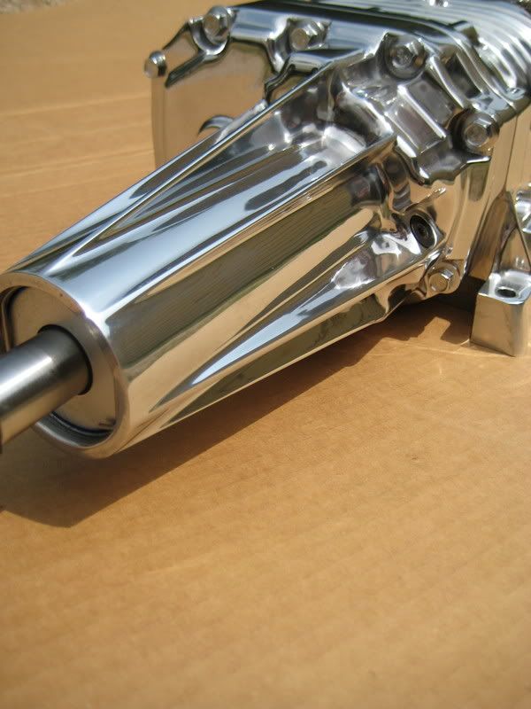

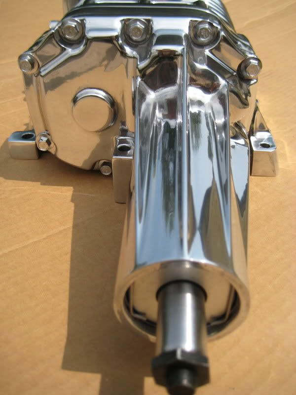

    If you like to go even further...I can ship out to you a fully POLISHED snout fully rebuilt if you like for a little extra. Imagine this poking out from under your engine cover.
    Or we can leave it stock and just rebuild and reseal it.
