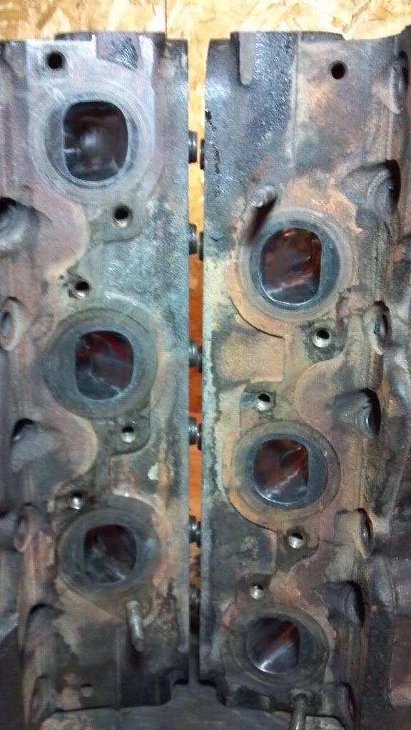

    Here is a set I did a month ago. Pic's aren't the best because I took them with my phone.
    Ported on the Right, stock on the left.
    The floor is only smoothed out and polished. Not much air flows down there, and you'll lose velocity from removing material there.

    Not all that much you can do on the intake side....gasket matching isn't necessary since the cross section of the LIM runner is smaller than the stock head intake port.

    Love how you drilled the whole lol. So what I'm getting at is for the intake side it's good to gasket match it for the port. But for the exhaust side you want to port it more toward a D shape? Any pics just for reference?

    You aren't the first to make that mistake, so don't feel bad.
    Lots of people have run heads with gasket-matched exhaust ports without issue....they might not be as quick as they should be, but no reliability problems.

    Damn bro, you got a mirror finish on those exhaust runners, nicely done. So far bad advice and poor decisions have cost me over 2500 dollars, no better way to learn in my book.
