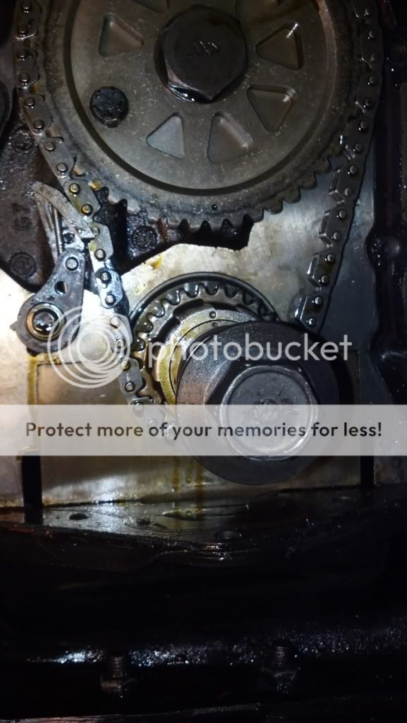

    I know this is old but i finally got the car going. I have had the car back up and running now since the first of the year. Here was the issue
    I replaced the chain and tensionor 20K ago and it broke. I am running 105# crow valve springs. Well seems like that was a mistake, so now i have a double roller on there. had to fit a coolant leak for what ever reason as well, and now the car runs just fine. knock on wood, all seems to be well with the car, plenty of power still. If anyone reads this and has a stock chain on 105# springs, my advice, get a double roller

    Looks more like you tensioner grenaded.

    Yeah, i needed a comma in there to break that up, the chain slack just simply let the car jump time enough not to start or run or do anything helpful

    The right side would be pulling the left around. And there wasn't enough to cause the chain to come off the gears, right?
    Good catch, was that the stock tensioner as well?
  20. #20 Re: misfire dead
    GTP Level Member 2001goldGTP's Avatar
    california
    656
    Yeah the chain stayed on the gears for the most part. The tensionor would bind up the chain to the point it jumped. The chain and tensionor where stock oem, i changed when i installed my cam.
