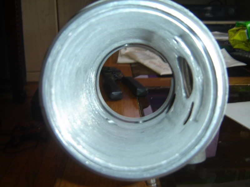

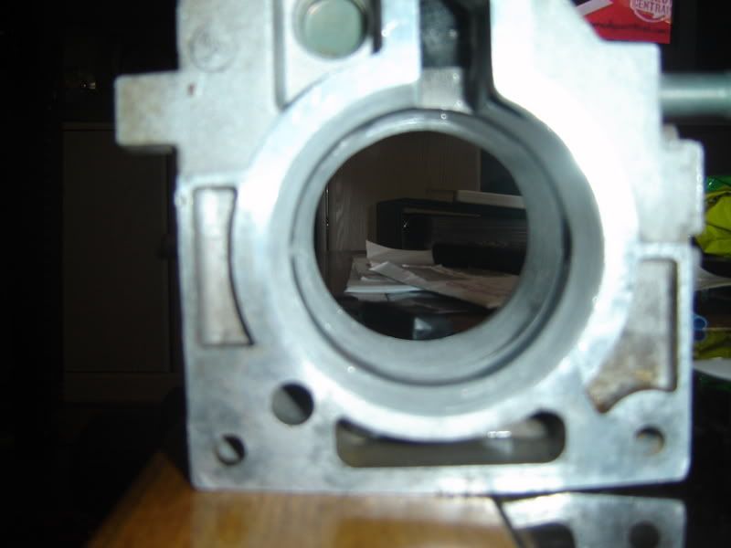

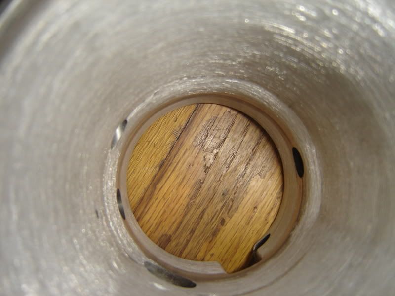

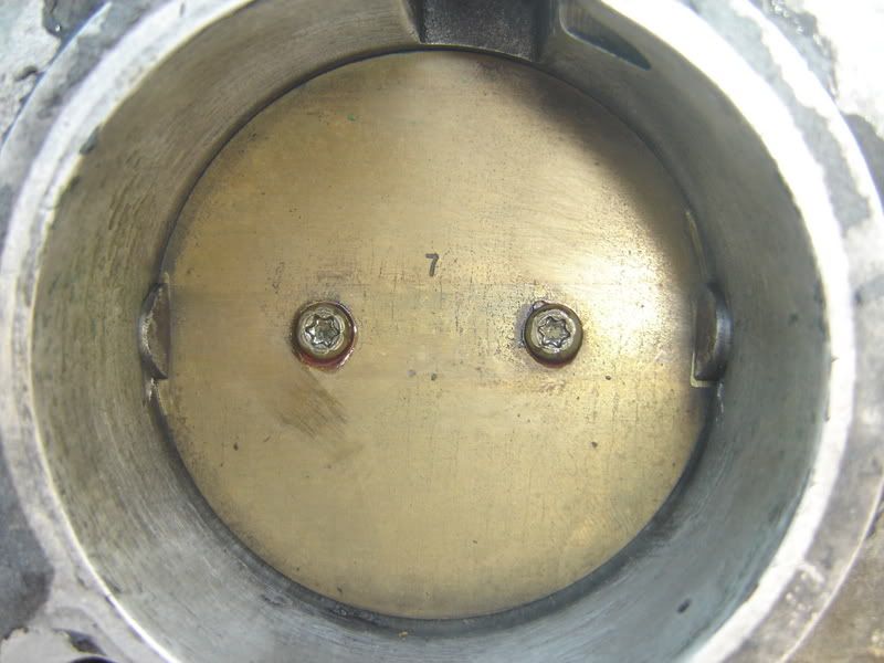

    just for kicks, i bought a spare for ~$30, and bought a box of sanding rolls and a few dremel bits like a tungsten carbide and went to town on the tb. i didnt touch the area near the plate for various reasons.
    i also cut the top half of the tb shaft and cut the 2 bolts holding the plate and used red locktite to prevent the bolts from coming loose again(funny/scary story). took a few hours over the span of a few days but i leanred a few things from it.
    PICS-quite a few....

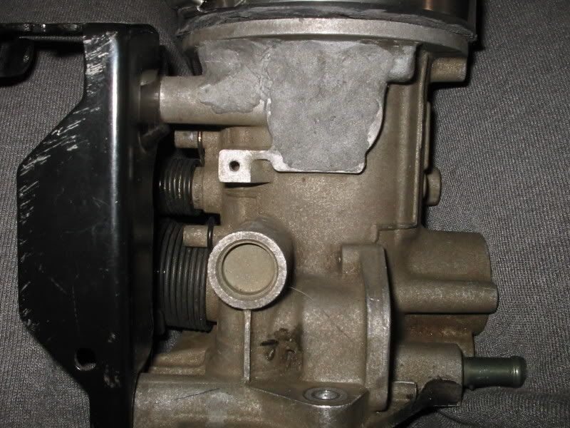

    The Before Shot....
    The Bastard, aka Reptile, at work on the TB...
    What was removed.....
    A little JB Weld ftw and some sanding down........
    And the TB installed...
    I can say I am a proud Green Bastard Products owner

    yep....im using an LQ4 MAF from the silverado lol...i sanded that area down since i took the pic
