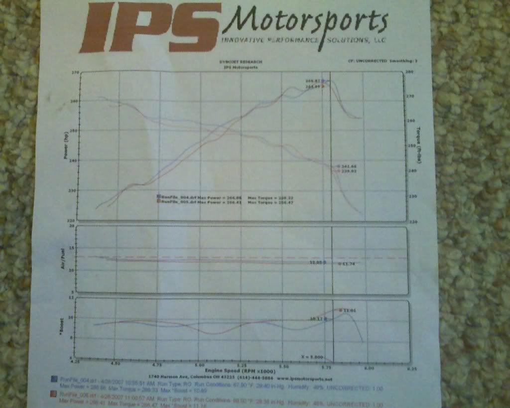

    I lost a solid 15-20 HP (and belt slip) between going non-coated rotors and coated. I think I put down 260 something non-coated and 280 coated.
    damnnn 15-20? What caused the belt slipping?

    Quote Originally Posted by logan809 View Post
    Wrong sized belt.

    Wrong sized belt.
    This. I was running (I think at the time a 3.1) pulley and had a belt on for a 3.4. The graph looked like a wavy line.
    Swapped to coated rotors and put down 280 hp. Probably just the belt slip though.
    http://i283.photobucket.com/albums/k...31/ipsdyno.jpg if you want to enlarge it. Peak HP was 266.

    If your belt was slipping on the dyno...that's more likely where the loss of power and inconsistencies came from more so than no coating on the rotors.
