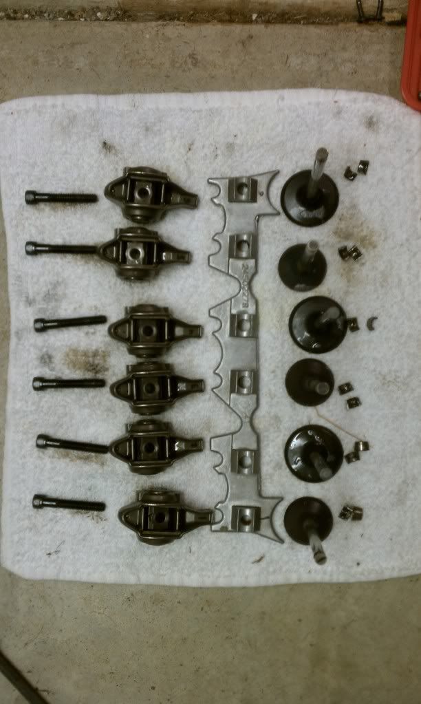

heres the stuff I pulled from the head that was on the car to use in one of the l67 heads

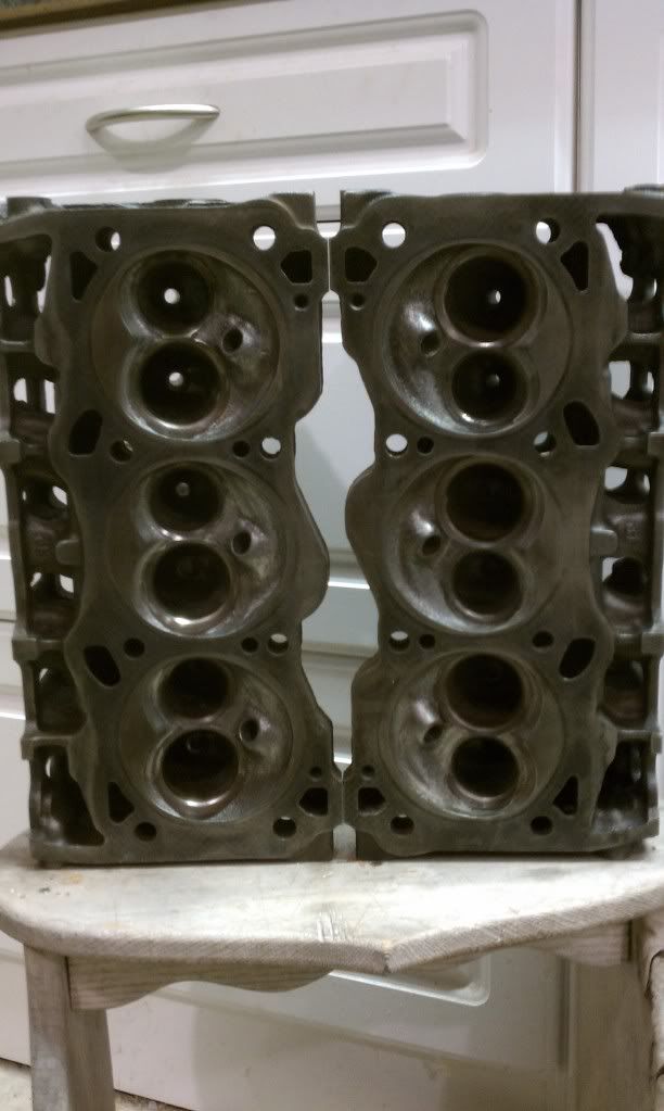

Heres the L67 heads as they sit now all they need is a valve job and their good to go

head looks nice.. im assuming red and not orange lol

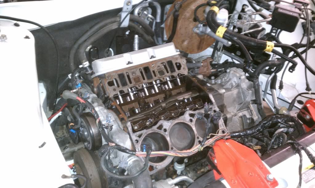

so how the hell do you guys go about removeing the rear head while on the car? main part is I can't figure how the **** to get the rear manifold off I wish I had a engine hoist this would be so much easier if the engine was out of the car
you dont have headers on it?
Just undo the bolts. should be something like 6 on the rear manifold to the head + one for the EGR. Crossover is two, downpipe is two. unplug O2 sensor and leave in manifold.
Should lift right up.
Can't really remember though. Been a while...
rear head isn't bad. Its just a stretch on the legs and back.

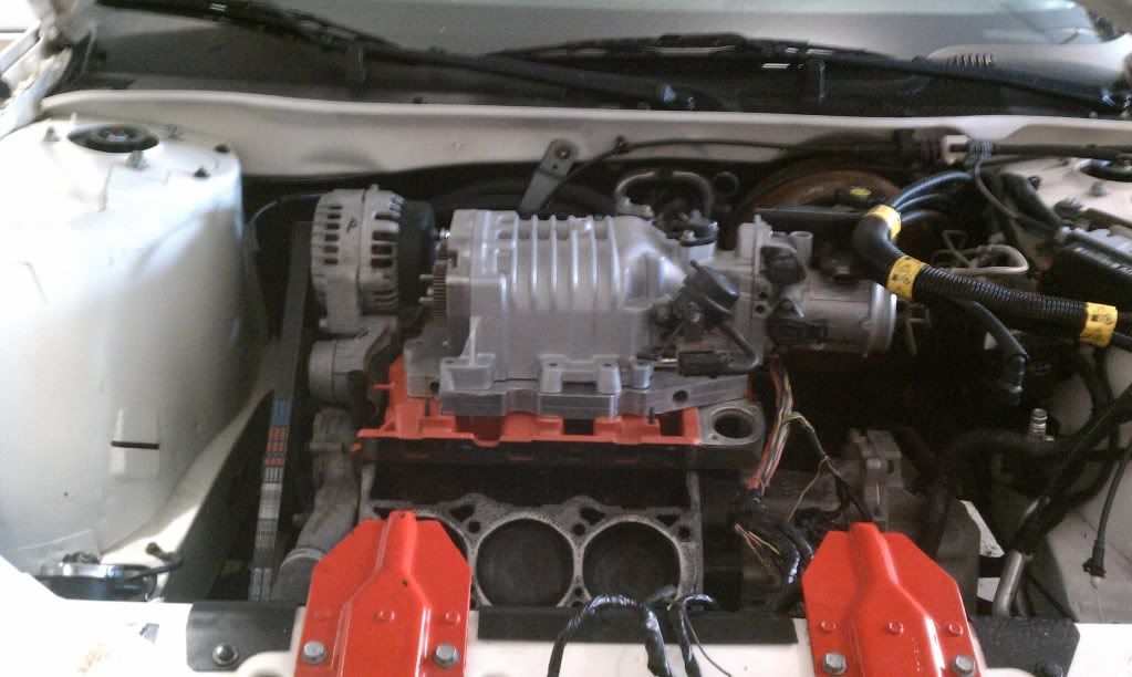

so I got a good bit done today and still have much more planned

the good news is I got the rear head off wasn't as bad once I pulled the engine forward.
my plan is by the end of the day to have all the wires re routed to finish up my wire tuck I started earlier in the summer.
along with that I want to have all the fuel line and rail stuff finished and the new connectors for the injectors installed.
I still got a lot of work but I need to have the heads and LIM on by tommorrow night
