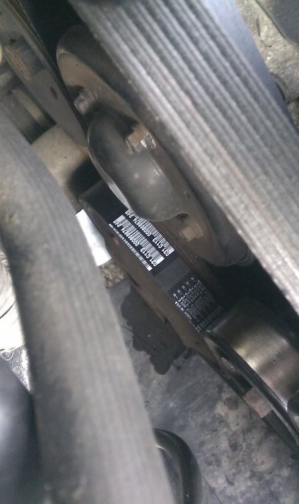

    Pictures say 1000 words. The crank is in the center of the picture. You can see it's got a very small overlap, and a decent gap to the divider on the pulley. If I move it over, though, it just moves back. Could it have something to do with the belt position on the smooth pullies?

    Hmmm thats too far over. Do you have a reduced S/C pulley? I accidentally bought a stock belt when I was running a reduced pulley, and it did that. If not, make sure that the belt is sat fully on the crank. It may look like it is on top, but you may have missed a groove on the back and underside of it. You gotta squeeze your hand back by the oil filter and feel.

    Yea, you're off by a rib

    Guess that was all. Reseated the belt and stuck my hand way down there and made sure it was on all through the bottom - sure enough, it stays put.
