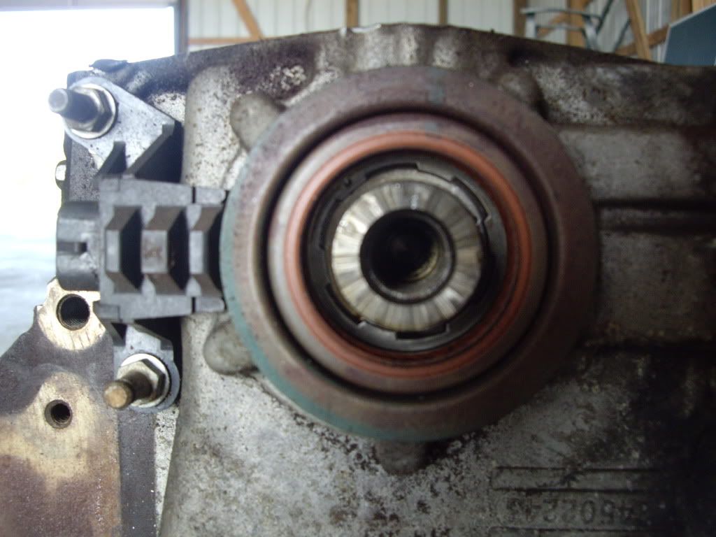

but, using those two pictures above, and this one:
is that everything that was supposed to come off or did i royally f*ck myself?
everything came off like it should
