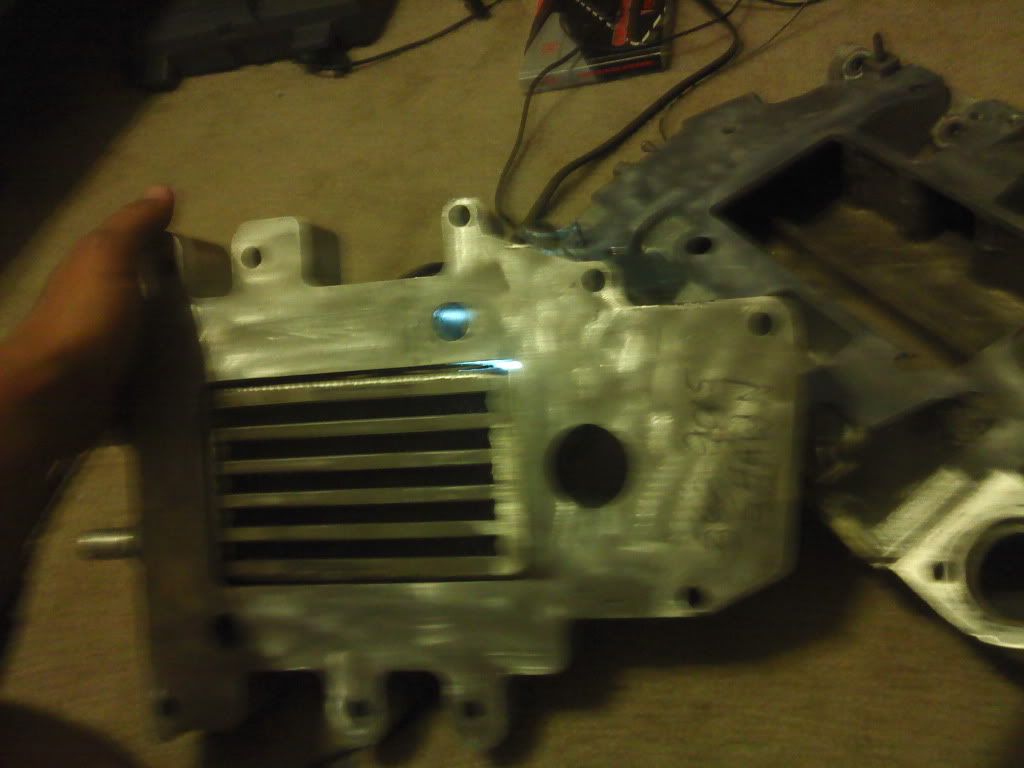

    I just recived my used stage 2 ic today in the mail i opened it up and all the parts where there.
    woo hoo.

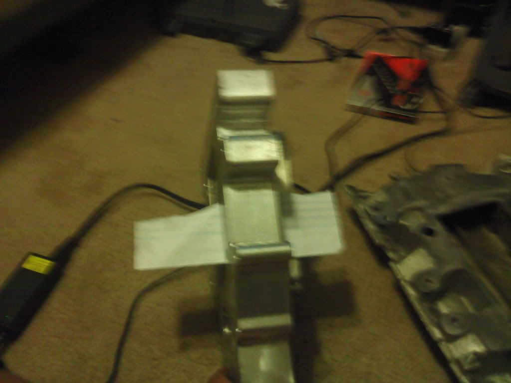

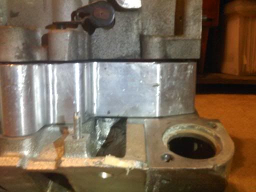

    But wait im looking at this thing and there is a huge gap on the side of the core
    I put a piece of paper through so you can see where the gap is
    and a side on view
    here is a front on shot with my flashlight shining through the gap
    But wait there is more the top of the core where it meets the sc by the bypass channel is like bent

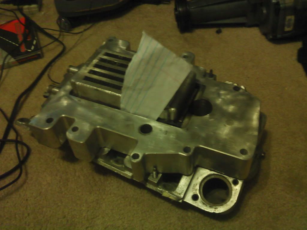

    so i decide to test fit it with my spare sc
    yup a pretty big gap that cant be good looks like im probably not goin ic this weeked.
    Well just wondering how bad i got screwed this cant be right can it?
    I paid with paypal so i might be able to do somthing about this just want some input on what i should do looks to me like prev owner tried to re core it and bent it and the core didnt fit right. fml

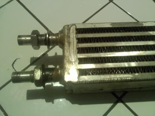

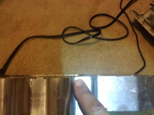

    So i took the core out and its cracked
    The actualy plate for the ic is bent were the lip holds the heater core. Its more noticeable on the right.
    This looks fixable would i just be able to get a newer style core and get that bent piece flattened back out.
    I paid 425 for it with a gm pump and a ported lim think its worth the extra money to get it fixed and does it look possible to fix it?

    I had one of those W body store IC's and loved it. Have you put water in the core to see if it leaks or if that's just a line from where it was made?
    On the bend.. I'd try and have that fixed/flattened. don't worry about that gap at all. Won't effect performance. If you want though..rough up the sized a little and fill it with RTV once the core is back in. Honestly though..I wouldn't.

    that is one of the better intercooler cores out there. if you can get it to seal right then it'll work like a dream

    Dam it Bio i was all convinced that I got screwed i guess ill take it to the machine shop and see how much they want to fix it.
    Also the core leaks bad i plugged it and blew through it and air came out so i took it out of the plate and that crack i circled leaked water bad when i filled the core.
