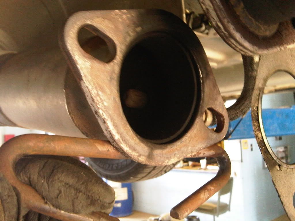

    Which way does the flange gasket go on? There is an "indented" circle and I was just curious if that is supposed to face the cat or the resonator. Here are the pics:
    As you can see here is the "bump out" side with the part number stamp on it.
    and here is the "bump in" side without the part number stamp.
    Thanks!

    Technically, it shouldn't matter, as the theory behind those gaskets is that they are compressible (footprint) gaskets, but per GM Service docs, the "bump out" side is to go to the manifold, as it's the more rigid surface.
    So "the "bump out" side is to go to the manifold" .... towards the cat?... since that's the direction of the manifold?
    this is going between the cat and the resonator on the down pipe.

    My best guess is the flange being warped (see my pm reply) but yes, toward the thicker of the flanges. Dammit, put an LS in that thing so I can reply without thinking. LOL.

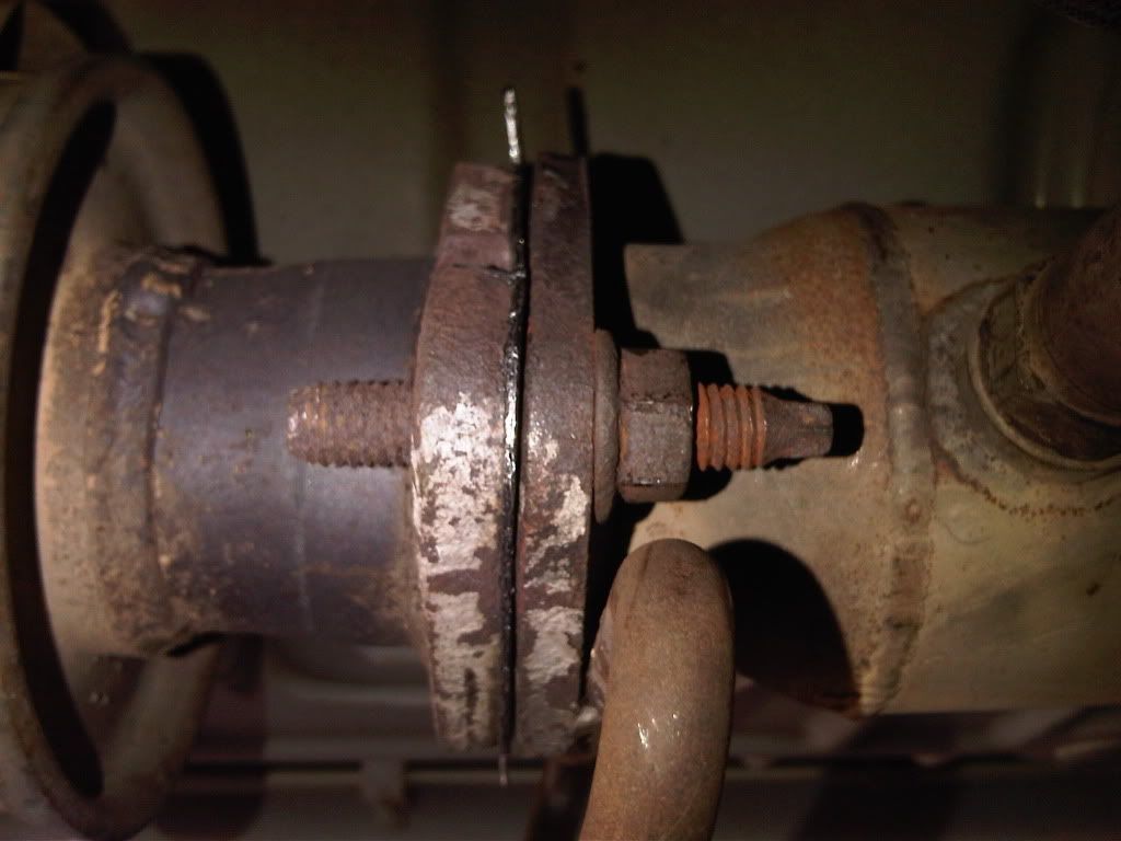

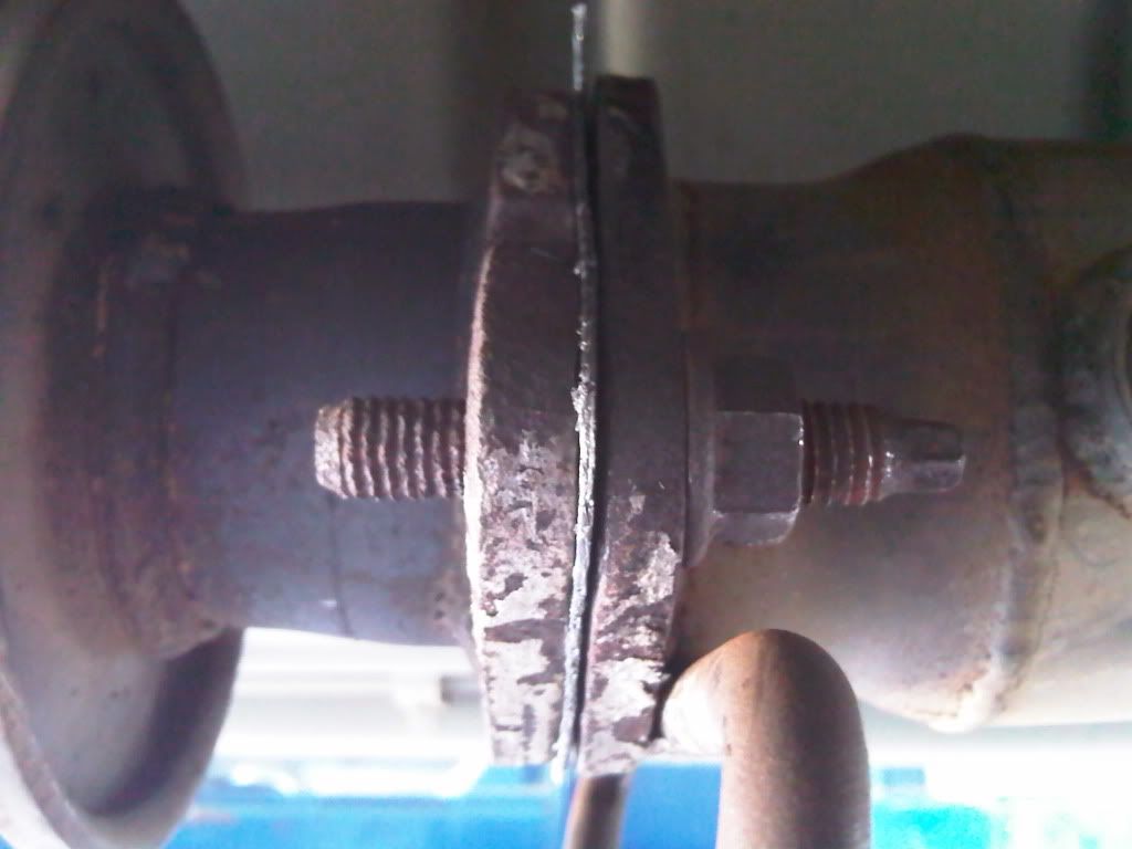

    alright, just got back from the lift....
    It's clear the gasket blew out on the top of the flange this time, not the bottom. Looking closer at the flange, it appears the top of the DP flange is actually warped outward
    I tried to massage it back into place, but it wasn't really working So, I just put the new gasket it and it's sealed for now... we'll see how long it lasts.
    Here's some pics.
    the dark spot on top is not a shadow, it's the burn mark

    well, it's fixed
    ...exhaust shop just cut the flanges off and welded the DP to the resonator...
    well, at least it doesn't leak anymore .....
