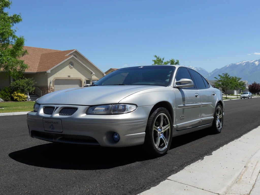

Well the car is back home where it belongs with some new projectors, HID's and some custom paint on the bumper. I washed the car last night so I could take some pics, but it got dark really fast and started raining. So whatever, I'll do that biz later.
Back to the thread topic. I've now got the car where I want it I just need to find a place where I can scan for KR. Assuming I still have some KR issues, what are the next easiest/cheapest KR reducing mods/adjustments that I can do? I really don't want to go too much further in terms of trying to squeeze more power out of the old girl. I just want to do the minimum necessary to have safe KR levels. So what are my options? Colder plugs? (Headers, I know). What else?
