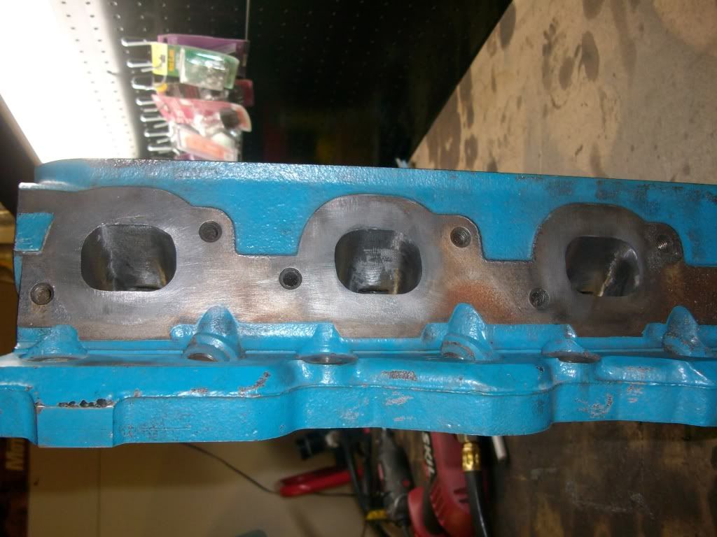

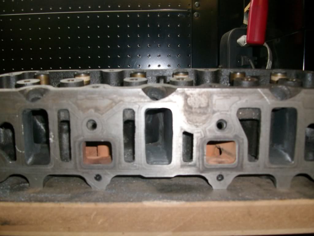

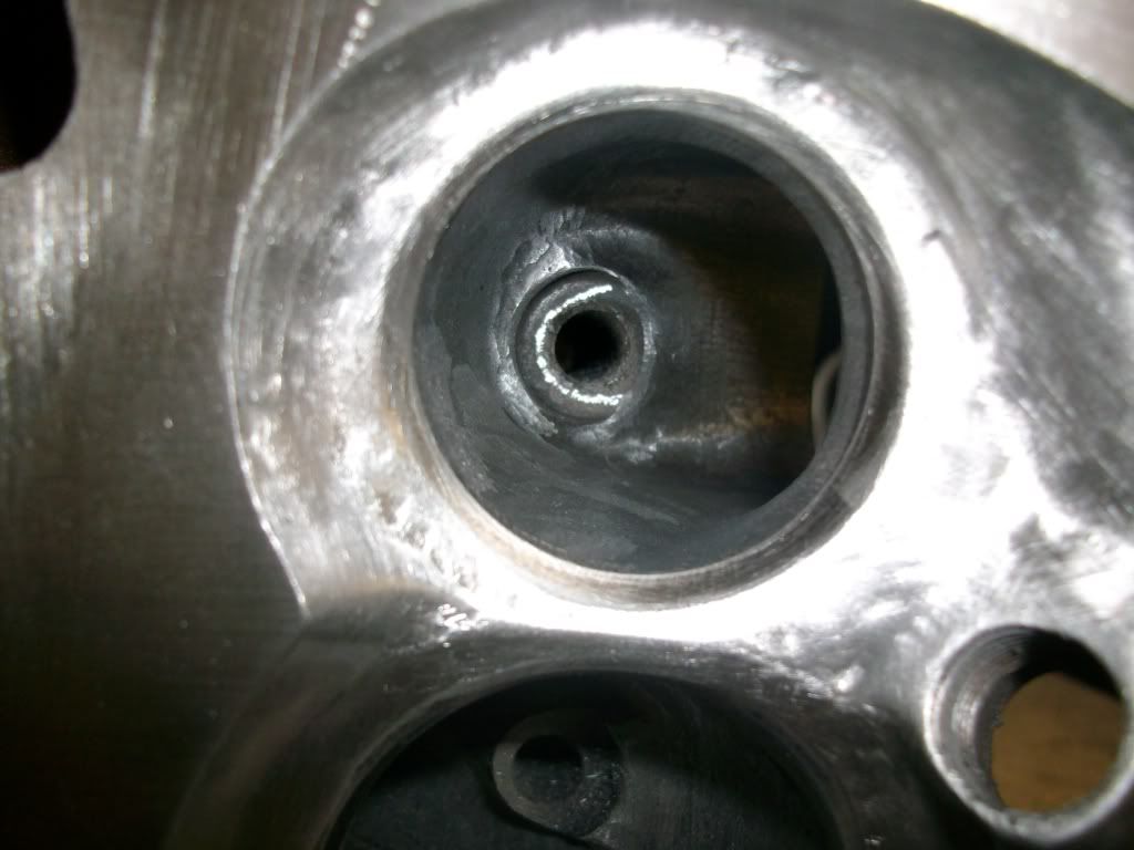

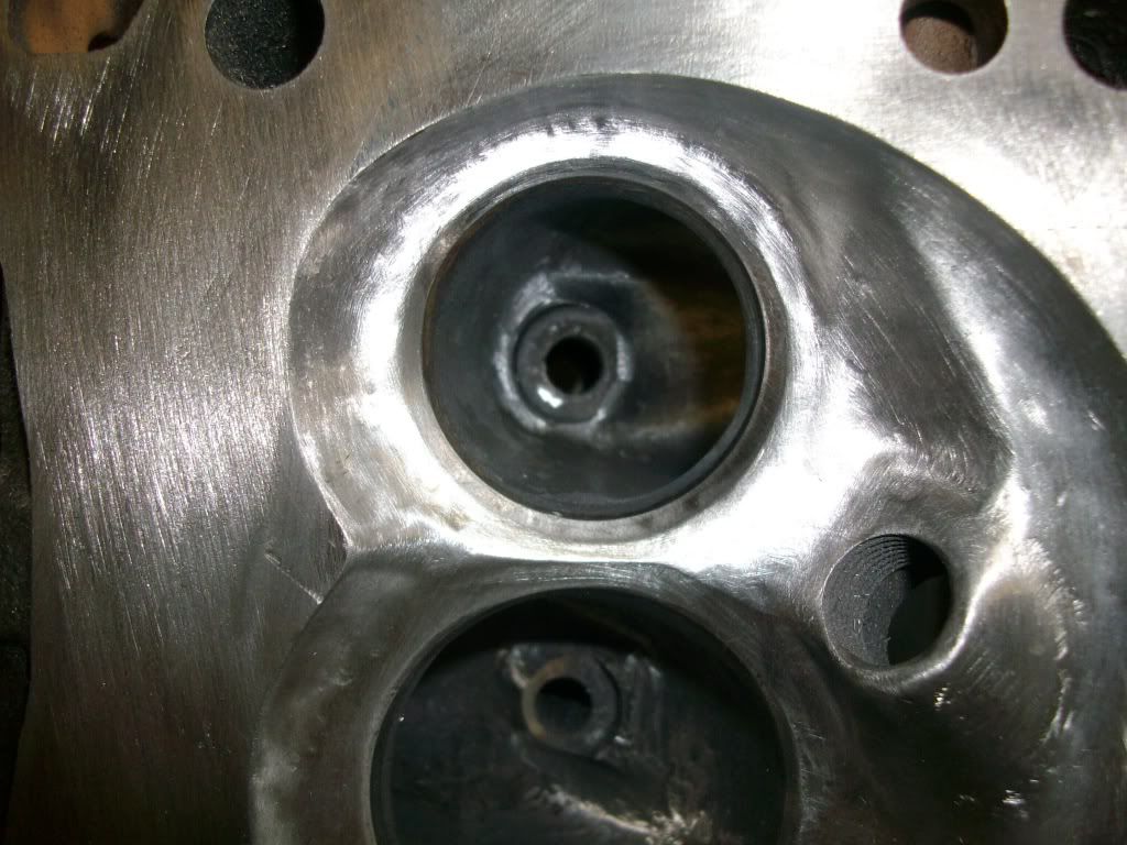

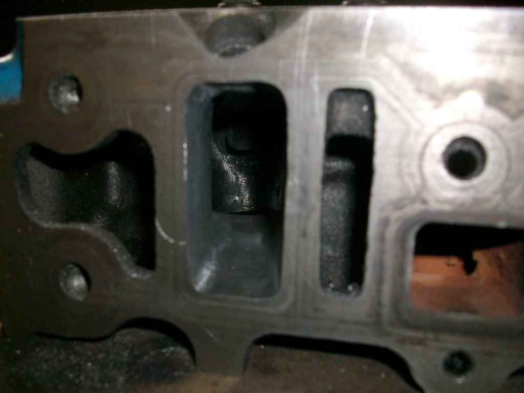

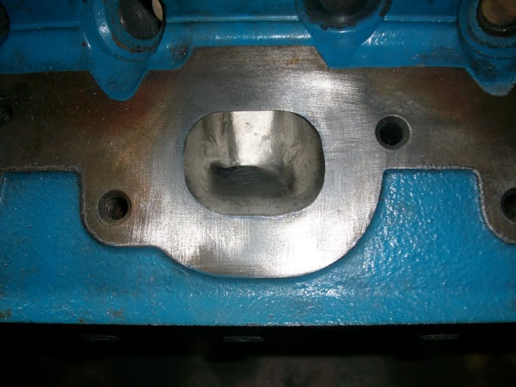

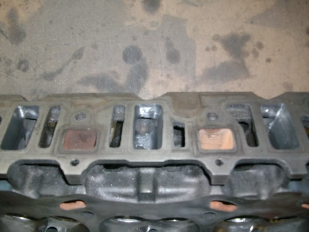

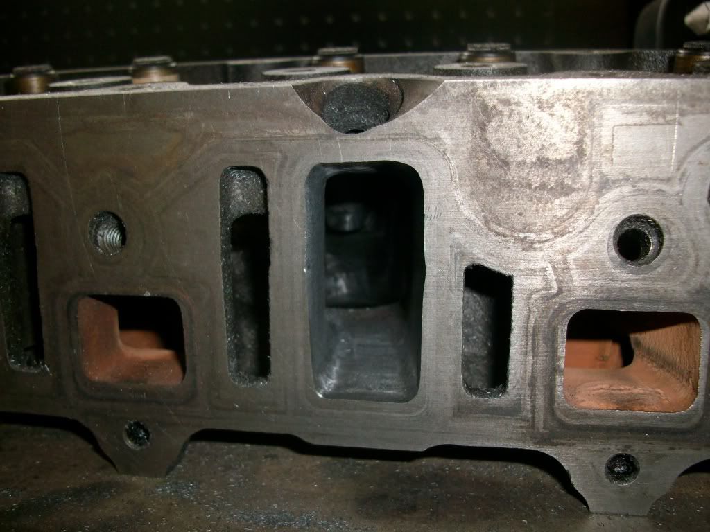

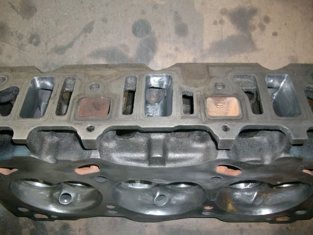

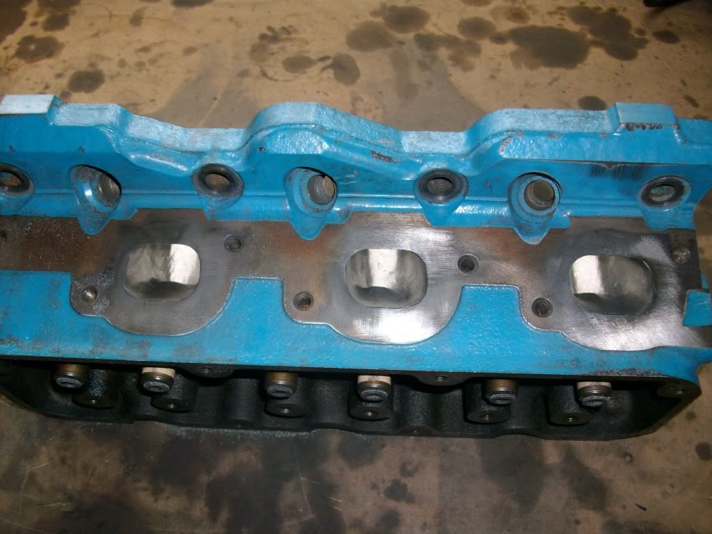

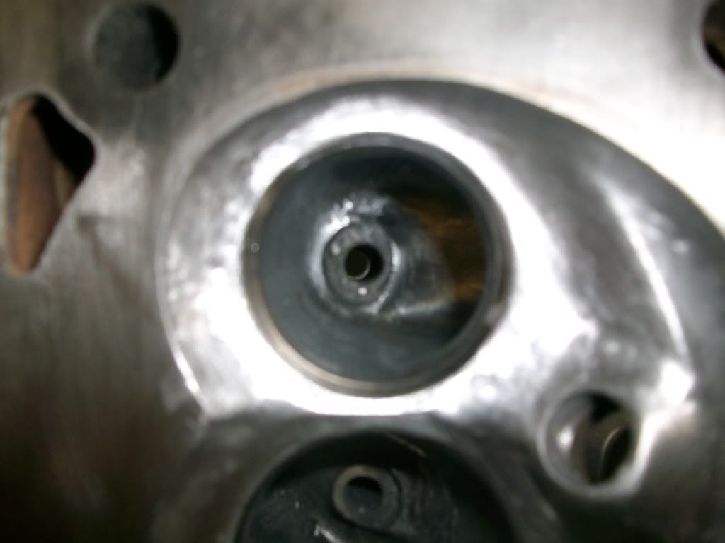

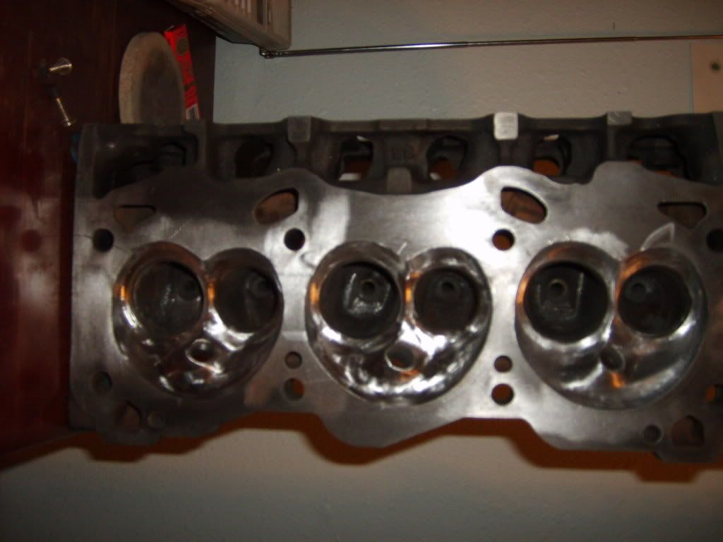

Heres some pics of the combustion chambers done. Just gotta get some longer bits so i can get farther into the intake areas. just about done with the exhaust side of the head. Give me some feedback.
hope you didnt knick any of the valve seats.
if you knick it to much the valve wont seal to the head when closed and cause you issuies.
If you dont have the valves reseated after you port your heads you are stupid.
im not that stupid to just slap the valves back in and be done. I plan on going with larger valves and getting a valve job and then probably sell em and get L26 heads
almost all of the gains are in the valve job, valve cutting, and bowl work. you can work for ever and not see ANY gains if you don't know what you're doing. the only way to know how you've done is with a flow bench...which you haven't.

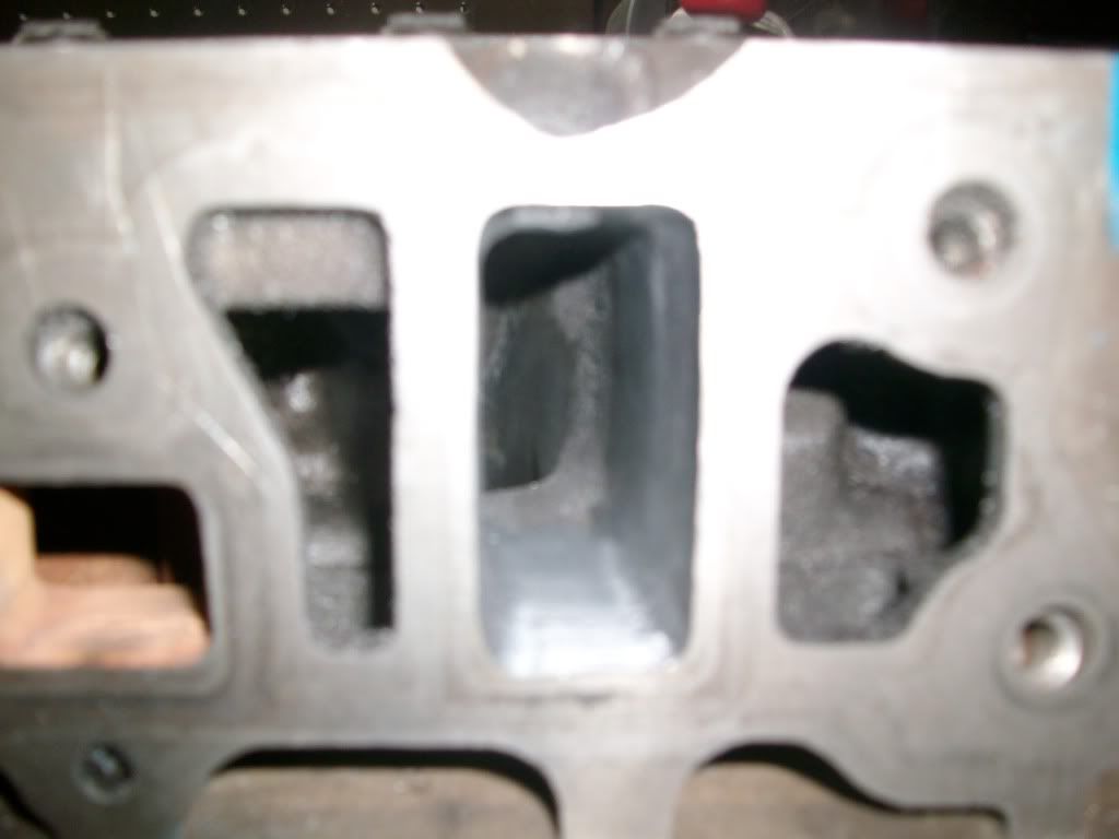

polishing the chamber with sanding rolls will reduce knock. otherwise the pics are a little too blurry to see your bowl work.
ya well sorry i dont have that great of a camera. These arent going to be perfect for my first time, that i know. Im just looking to see how good i can do. if they get screwed up. start on another set.
id like to get them on a flowbench but we dont have one here. i went in there 6 months ago to see if they could port some heads for me and they cut me off and said no because they didnt have a flow bench.

yea, i guess. there is no gains in hitting that area tho. if your not going bigger valves your just spending more money at the machine shop then neccecry. just clean off the carbon with solution.

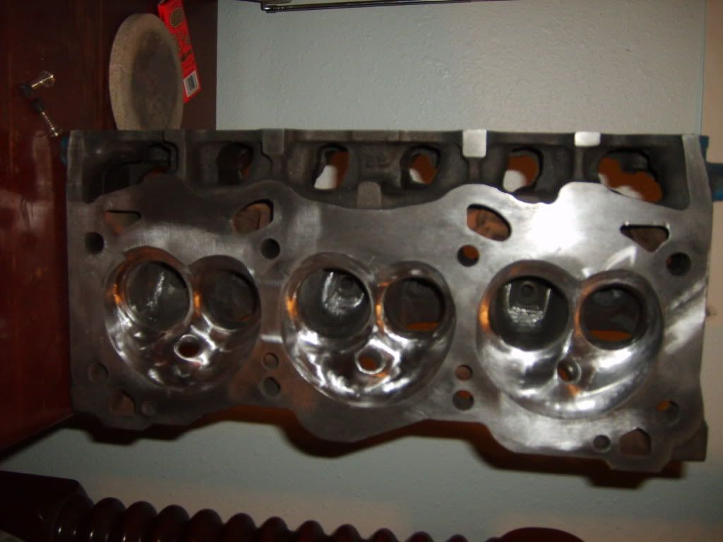

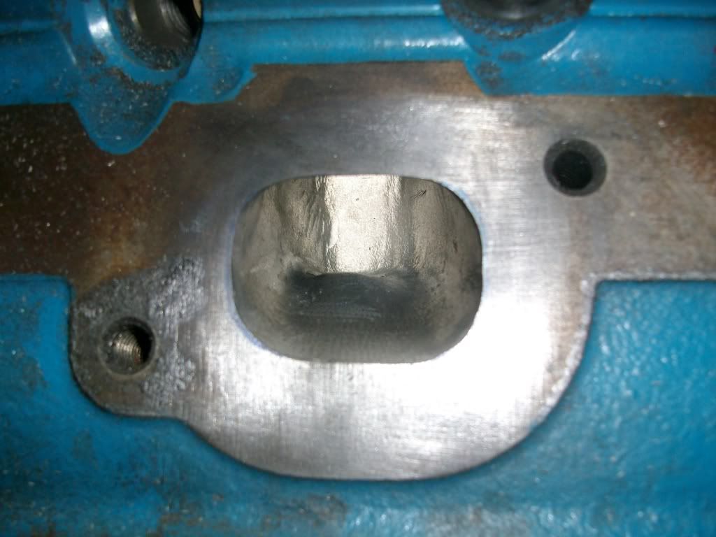

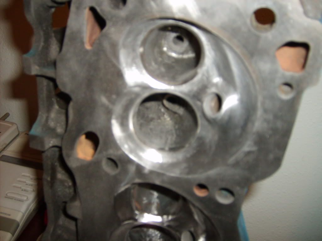

Ok well here is some more pics. This head is just about done. But not quite. Got finish the rest of the intake yet. But heres the pics. let me know what u think.
