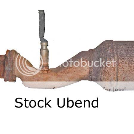

    As far as the intake...it has a fuction ram air...I looked at it and it is not true as I would have hoped...it has to travel over to the air box through a little hole from the side of the hood, it says it add 5 hp over a standard GTP, but who knows...and U-bend delete...What is that?
  6. #6 Re: First Mods, what should they be?
    Barksdale AFB, LA
    4,879
    Quote Originally Posted by SteelCityTA View Post
    Look under the car at the exhaust in the general area of the front seats. You'll see what the u-bend is.

    [IMG][/IMG]
