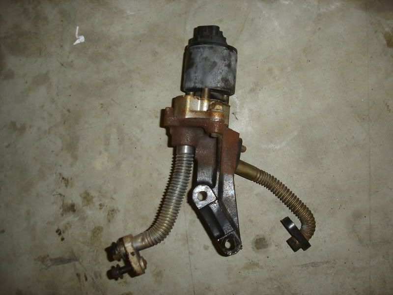

    I had mine off when I replaced my LIM gasket last year and I just cleaned every part of it that I could with regular brake cleaner.
    As for where it is located, if you stand at the front of the car, looking at the engine it will be on the back side of the engine, right hand corner. Just behind the throttle body. Below is a picture of what it looks like.

    FYI, you don't have to take it as far apart as Scotty did for a P1404 code. Just unplug the electrical connection then remove the two bolts at the valve itself and lift it off.
    I picture is worth a 1000 words.

    Yeah, I guess I should have clarified that. I was just using that more as a reference to what it looked like. But good point nonetheless.
