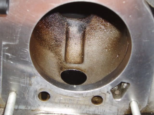

    when i installed my new tb today i took my old one off and i was disgusted with what i saw... the inside of the s/c inlet and back end of the old throttle body was all black with this stuff caked on it (carbon buildup?) tried getting off as much as i could, but didnt fare off too well... is this normal? and how the hell can i get rid of it???

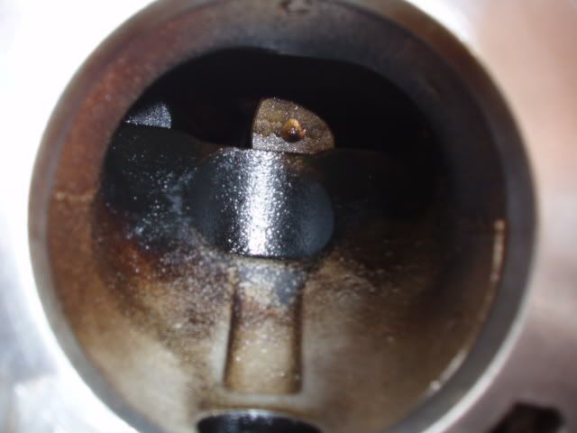

    Barksdale AFB, LA
    4,879
    Quote Originally Posted by 2000GTP View Post
    oh yeah that makes sense... after all it does put exhaust gas through the intake... no wonder
    Mine was kinda bad too...
    http://img.photobucket.com/albums/v3...2/DSC02405.jpg
