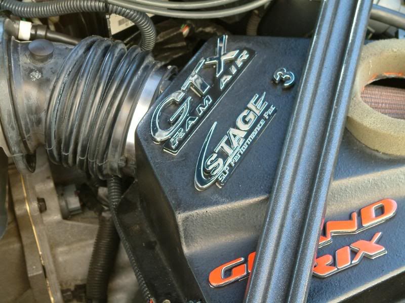

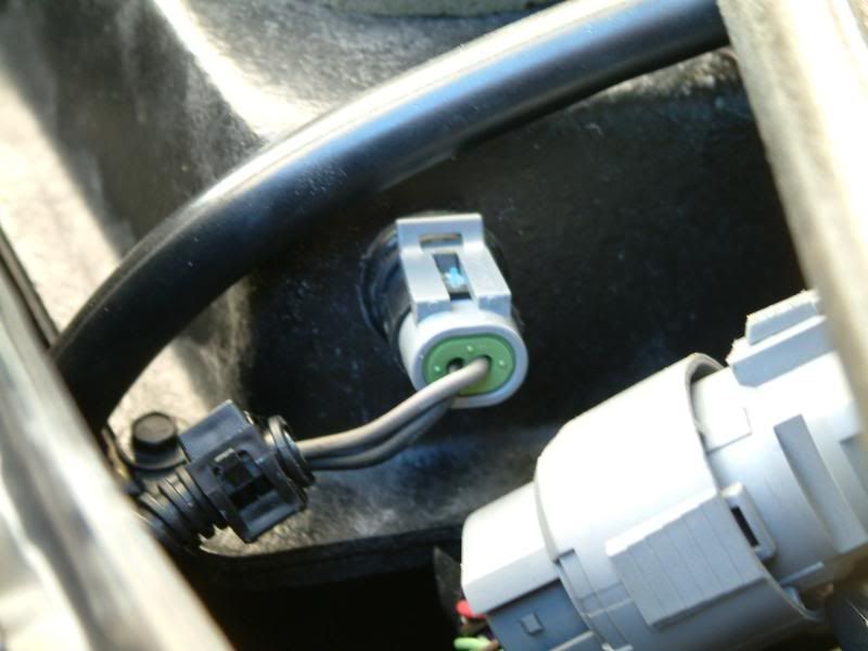

You can find this info in any number of books. On a daily driver thought that hot air makes a big difference. Last summer, after reading what Mat T wrote I thought ok, maybe the real engine builders may be wrong so lets test this open cone thing. My main thought was, if this really works I can get rid of a lot of clutter under the hood. On a hot summer day I pulled my Wizaired out and installed an open cone. The car was noticably slower driving aound at 45 MPH. I was watching my IAT's which never got below 120* iirc. I went back home and within about 45 minutes I had the wizaired back on and repeated the same path. Like normal the car was very responsive and IAT's while moving were never more than a couple degrees above ambient.
