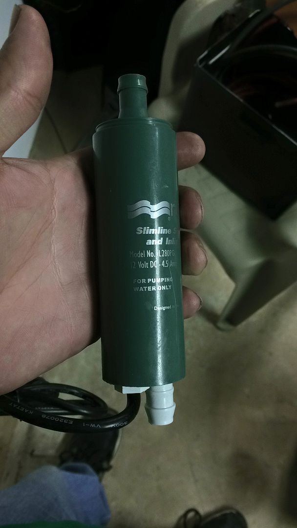

    How about one like this? It's about 6gpm and I like the inline design.
    I have seen the "Auxiliary" pumps as well listed for most of the German cars and they seem to be for some of the SUVs and I was thinking maybe they are for rear heaters or something but they are only like $30-$40 each.
