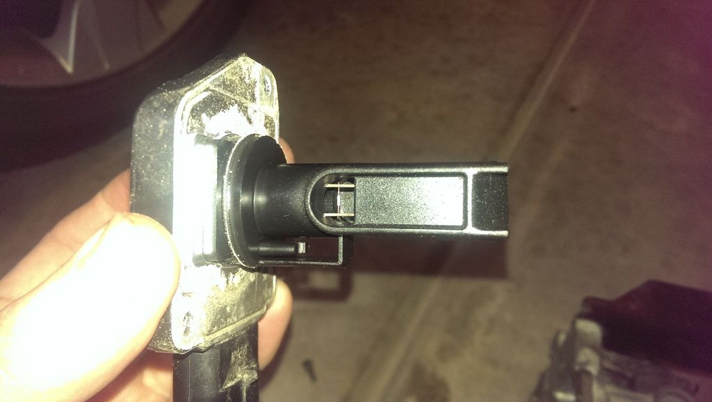

    I checked the TB, had a little bit of buildup on it, so i went ahead and cleaned it up. The maf from what i can tell(pics included) looks clean to me. My spark plugs were due for a change so i just changed them, also just installed a new wheel bearing and hub assemble because i had a bit of play in my driver side tire. Im going to hook up my HPTuners and find a empty parking lot to see if i can get it to happen again, hopefully tomorrow. I will report back my findings when i do.

    Found a parking lot and tried to recreate the issue again, I turned the wheel every which way in forward and reverse, also tried to duplicate the exact way i backed into the spot when it shut off last time. I had no luck getting the engine to shut off. From HPTuners the lowest my RPM's ever got was about 580. Only difference was it was about 75 outside vs 60 when it happened last time, The drive time was about the same as well.
