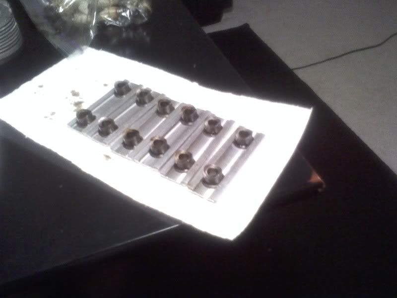

    I just thought of an interesting question that maybe you guys can answer for me. I bought these roller rockers used but they did not come with pedestals so I have no clue If you need them or not. I tried looking on different sites and wasn't able to find anything. Maybe I'm just being paranoid and I don't need pedestals but I figured I'd ask.
    Sent from my Droid Razr using Xparent Red Tapatalk 2
    Gremlins always seem to show up in pairs, or groups of three with our cars...
  15. #35 Re: Comp Cams 1.9 Roller Rockers
    Minnesota
    1,409
    I am pretty sure you don't need them but ZZP was the one who had Comp Cams make these for them so you could contact them if someone else doesn't respond.
  16. #36 Re: Comp Cams 1.9 Roller Rockers
    Asking ZZP is like getting no responses anyways...
    So, yeah.
  17. #37
    GTP Level Member apierce1289's Avatar
    United States
    500
    I just got an email from zzp and they told me these need standoffs. Idk where to get these. Google wasn't much help.
  18. #38 Re: Comp Cams 1.9 Roller Rockers
    Minnesota
    1,409
    Standoffs are probably the the same thing Harland Sharp rockers use. It's basically a pedestal for 2 rockers instead of I full metal piece that is for all the rockers. They might be singular like the Yella Terra rockers instead of double like the ones below, but I don't know for sure.
