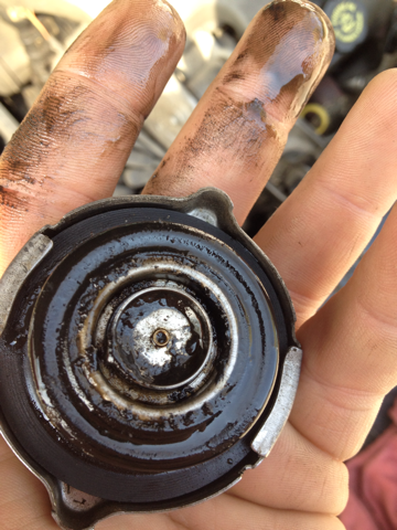

    I'm almost positive it is oil yes, but it could be trans fluid i guess. I haven't checked it yet as I just got the car back from the ex. I will have to check the trans fluid to confirm what it is. I pulled the cap to check the anti-freeze and seen the gray/black gunk on the cap, then fingered the rad and it came out the same way as the cap. It seemed more black than anything so I assumed oil and bad hg. Hopefully its the rad/cooler rather than gaskets!
  7. #7 Re: A few issues
    that sounds like dex sludge. take a pic and post it. you may just need a coolant flush. to deal with that part of your problems.
    you can bang on your cat, listen for rattling inside it if so the cat is bad. if you hear nothing try the o2 sensor.

    I think it's just the sludge that occurs when the dexcool and green coolant get mixed. Do a coolant flush and you'll be fine,

    Ok guys, here's the rad cap and what I wiped out of the red neck.
    [IMG][/IMG]
    I looked and looked for oil cooler lines and all I can find are 2 trans cooler lines and the rad hoses, so I'm gonna have to say no oil cooler on this car. I checked the trans fluid and it was at normal level and looked in good shape. The rad is low on fluid and from what I can see of it, it looks kind of orange ish green.

    do a coolant flush
