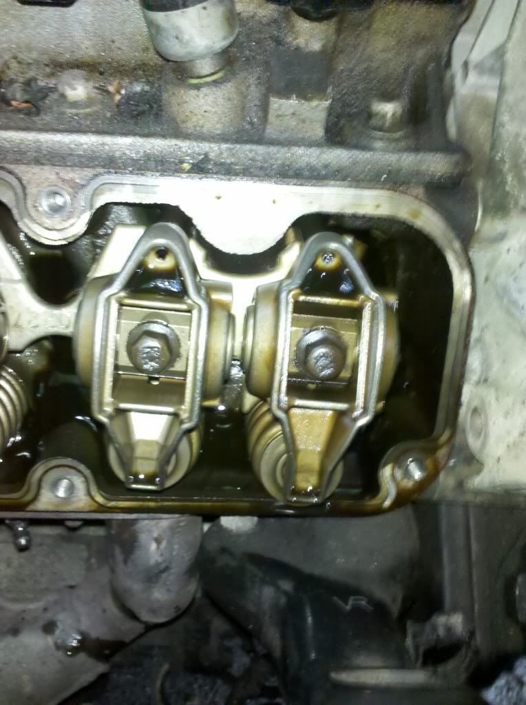

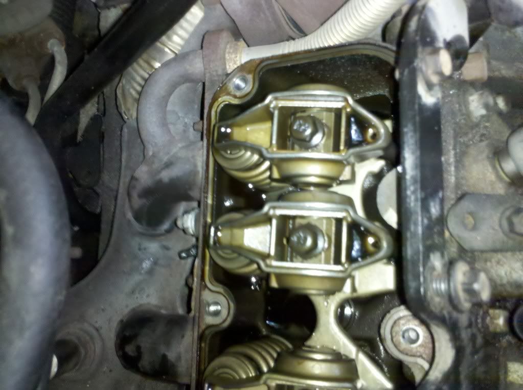

    OK, got the back cover off. Nothing visible. Looks fine to me. Everything is pretty tight. Guess I'll drain some coolant and get the LIM off now.
    Here's some pics:
    From overhead
    Cylinder 6 up close
    Cylinder 4 up close
    Cylinder 2 up close

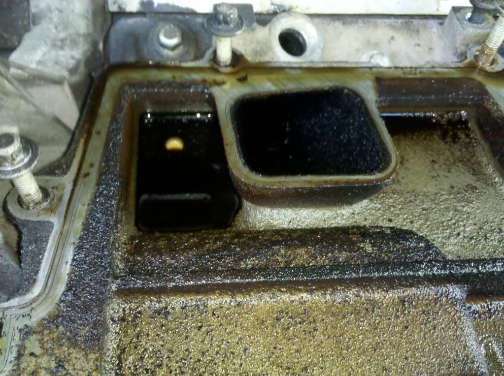

    Got the UIM off. Is it normal for there to be oil in the front drivers and rear passenger corners of the LIM.

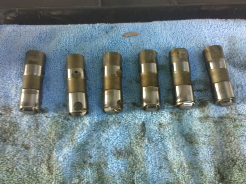

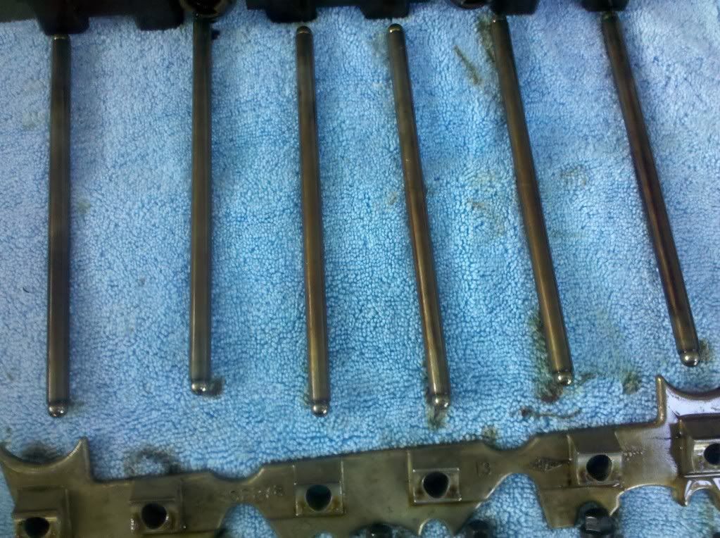

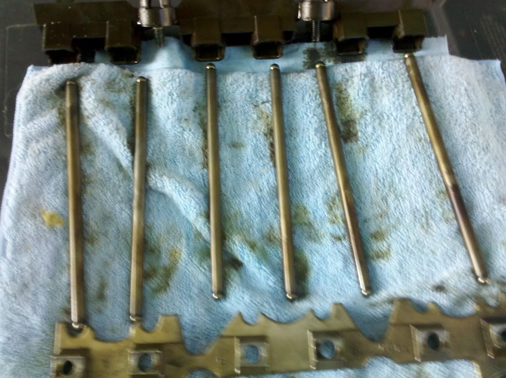

    OK, LIM is off, pulled the rear rockers, push rods, and lifters. I only did the rear because the code was P0304 and the knocking sounded like it was coming from the rear. From what I can see, everything looks fine. Gonna go pull the front ones now.
    Here's some pics:
    Left to right: 6 4 2
  15. #15 Re: Engine Knock
    GT Level Member tdm571's Avatar
    Lakeside Park, KY
    311

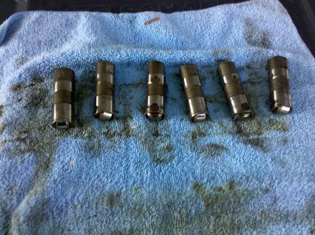

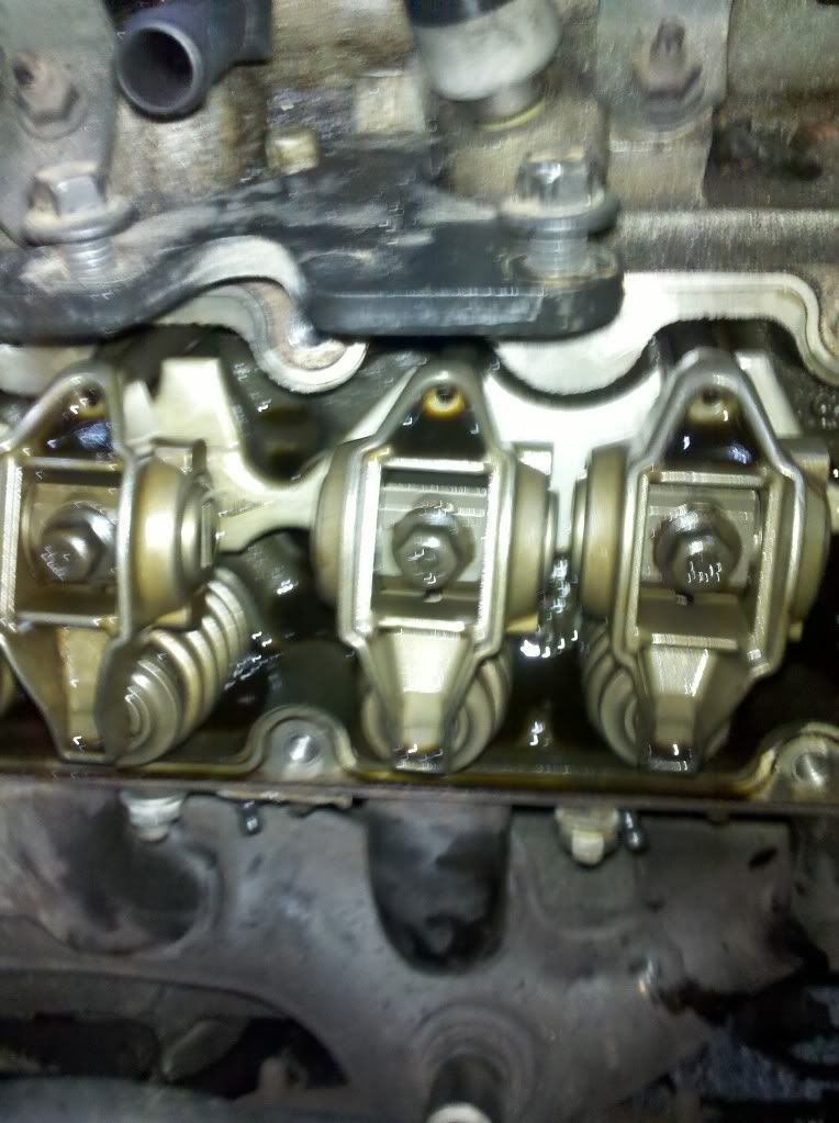

    Fronts are off. I see nothing. At this point, I'm assuming it's a bearing or piston because it sure doesn't look like the valvetrain. Going to put her back together and ponder on what to do next. Not sure a 97SE is worth a new engine.
    Final pics:
    Left to right: 5-3-1
