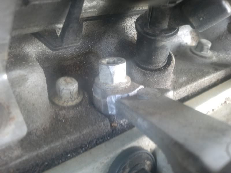

    It was missing the other night extremely bad. I left before it warmed up (and yes i did push it/was late for work) and my car went into a reduced power state. Same type of feeling when I burnt my valves and cracked a head a year ago. But since then its been running fine. I did see some white smoke saturday but it also went away. But so far its only ticking. Was only in cold starts but now its all the time and loud. Ive tried seafoam and other products and also 3 oil changes. Twice this month the ticks were extremely loud; once the day of the first incedent and again the day it smoked. I also just took a look at my dog bone and the motor mount is broken. Completely snaped. Ill post a pic in a minute. Could it be related to lifters?

    OP- You say you looked at your dog bone and the motor mount is busted? Well, which one is broken, the dogbone (the 2 mounts up front that bolt to the radiator core support) or the ACTUAL motor mount that sits on the pass. side of the motor under the crank pulley? Confucius say what?

    Part connecting dog bone to engine. Sorry if I have terms wrong

    Ah, its the aluminum mount that the dogbone attaches to on the pass. side. Common area to crack. No, this would not affect the lifters but does need to be replaced.
    If you can't find a used one at a JY then I may have a good one laying around I could sell. IIRC, there is a year(s) that had a steel mount there that may be better to use.

    Could be actually metal on metal contact between the swaybar and the downpipe if the motor mount is totally destoryed...somethings making contact that shouldnt...which could also explain your "reduced power state" as the motor thinks it is knocking really bad when in fact it is false knock and its pulling power for no reason.
