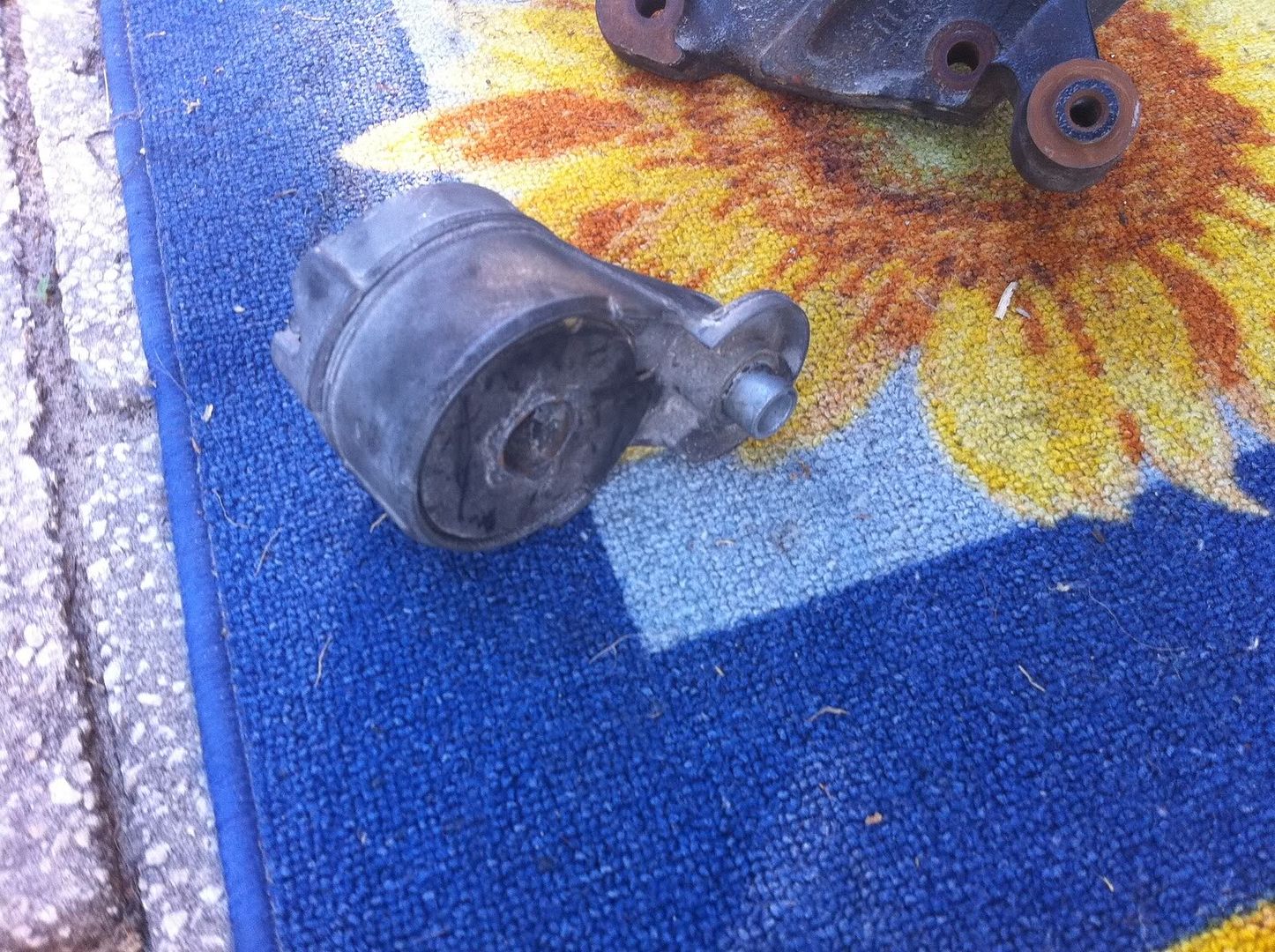

    Ok thanks everyone for clearing that up. However I have another question.
    How in the world do I attach the SC tentioner to the coil bracket? am i missing a part or something?

    I have the pulley for it. Im just trying to figure out how the tentioner attaches to the bracket

    the black end is going to be facing you. the pulley on the down side, u will see little tits on the top of the back of the idler, one little tit kind of hangs off the edge of the coil pack bracket.

    that seems upside down from the other pictures ive seen. well more like rotated 180 degrees. I thought there was a little groove where the 2 circles went around...heres pics for better explanation. like up the red dots with the 2 circles on the back of the tensioner and the green line with the raised tab thing...

    ^ no sir. My gm service manual and both my cars have it the way as the pic, and all 3800 s/c has it that way. The pulley on the idler should almost line up with the dummy pulley that goes below it on the coil pack bracket.
    and if that isn't convincing enough then think, how does the pulley fit with the coil packs in the way.

    Thanks for the reply's. The bracket on the park avenue and Bonnevilles are different as they dont have a dogbone so that may be a cause in the differences. I do understand how to mount it up now. thanks for the help.
