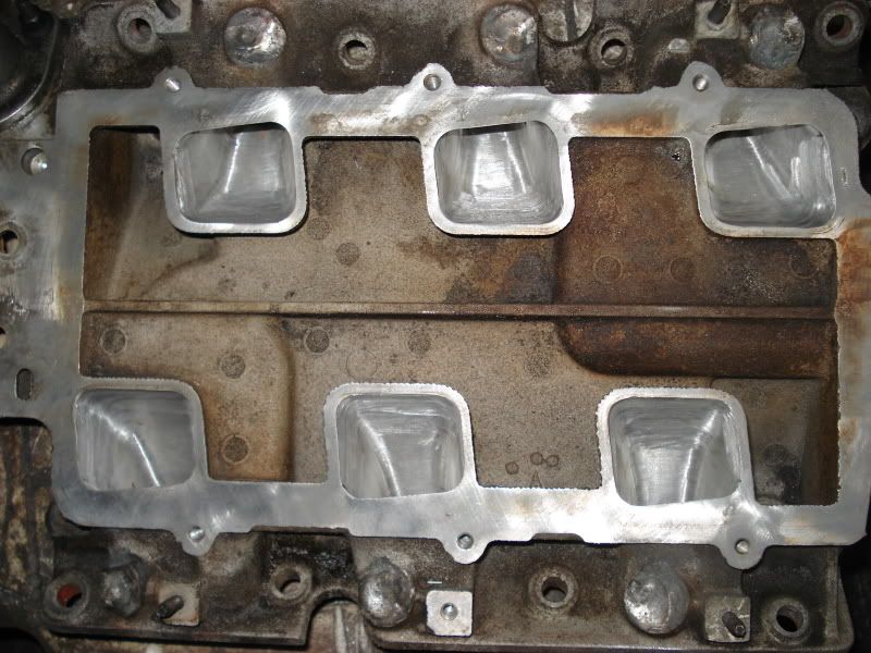

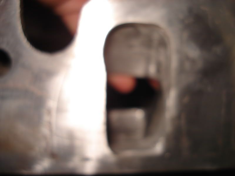

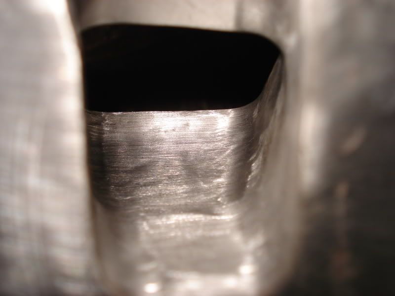

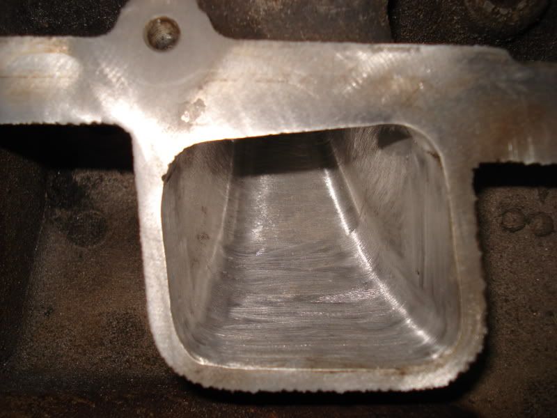

    Here are the pics. You will see what im talking about. On the l26 it has the side where the injector goes and the casting has a little half circle. Im guessing this is normal, but i matched it to the gasket like normal so i guess its fine. P.S. the injector bungs are welded shut, this is going on a turbo setup.
