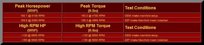

    For those who haven't looked, here's their results in early 2003 from the testing on a GP GT with minimal mods:
    Stock UIM dyno chart
    HV Insert dyno chart
    Even the torque numbers improve when removing the restrictive stock runners, shifting peak 200rpm higher wit a 2ft-lb gain, and remaining 25ft-lbs higher at redline. Not to mention the peak and redline HP gains.
    I've even heard that removing the cage alone, will start you on the path to these gains (possible proof in old CGP threads). The HV insert would then reduce the turbulence, add a little runner length, and smoothly direct air to the ports. I plan on monitoring airflow gains from this with another local's L36 I've started tuning, while they save up for an HV3 to install.

    Despite the fact that the car they used for the test had rockers and then continues to claim the part will add 30 HP by itself.
    Sorry, it kinda is in the details.
