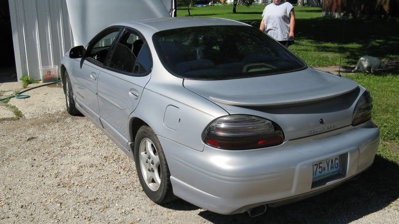

    pics of it...
  5. #5 Re: new 1998 GT no start !
    Interior looks good...just need to figure out what is wrong, debadge it, get some new taillights and tint them and the windows and have me detail it for you...it'll be the sex

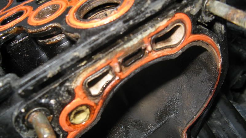

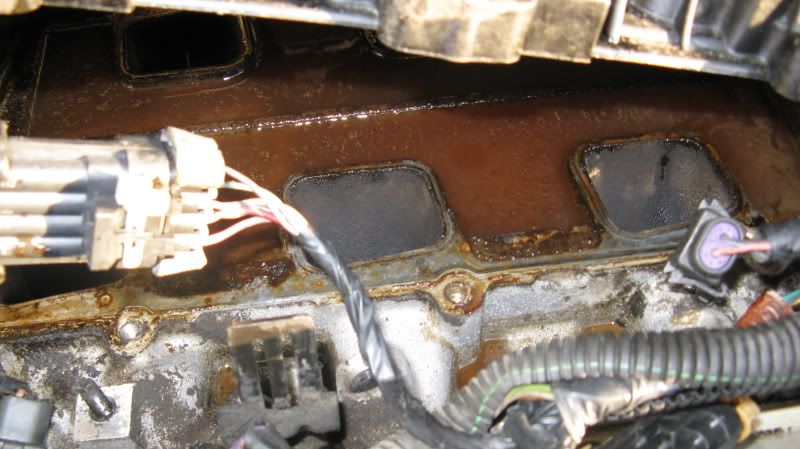

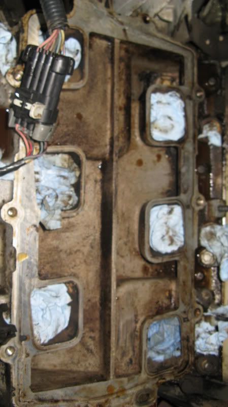

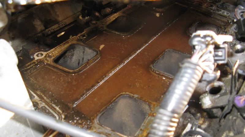

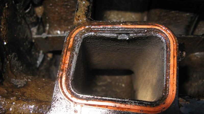

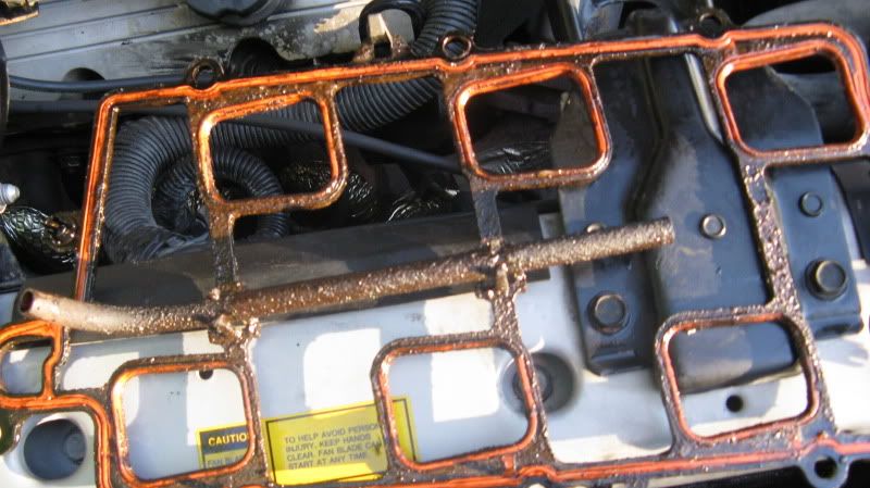

    looks like it was the intake gasket.....
    looks like the TB is leaking to...
    is this notch suppose to be there ?
    all good for the new intake gasket...
  12. #12 Re: new 1998 GT no start !
    Awesome LOL Might as well tear into it the rest of the way and do it right while it is all off...get the Lower Intake Manifold gasket done too...if the Upper was that bad the lower probably needs it...

  14. #14 Re: new 1998 GT no start !
    Quote Originally Posted by pughman View Post
    where am i going to get all the stuff i need , and what all do i need ?
    Get them from a GM Dealership...the Aluminum Lower Intake Manifold gaskets...also pick up some new Coolant Elbows for the LIM whileyour there, just a few bucks. Get some red RTV to seal it up too...Should run ya around $50 or so...

    damn man, that is a nasty looking gasket, i need to do mine as well, and the valve cover gaskets, mine are shot
