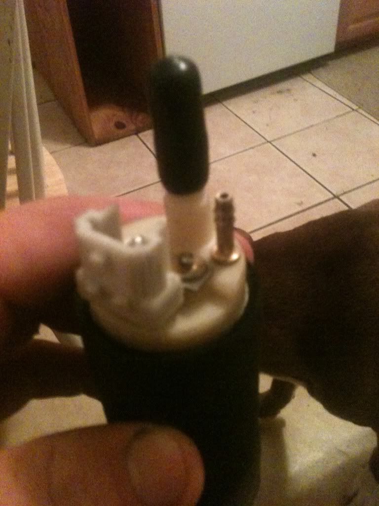

    Well my boss had a new fuel pump laying around so he gave it to me. It fits fine but there is one other bit on it that the old one dos not. Can i just put a cap on it? what is it anyways? First pic is the new fuel pump and you can see the brass fitting on top and the second one is the original fuel pump with no brass fitting on top.
