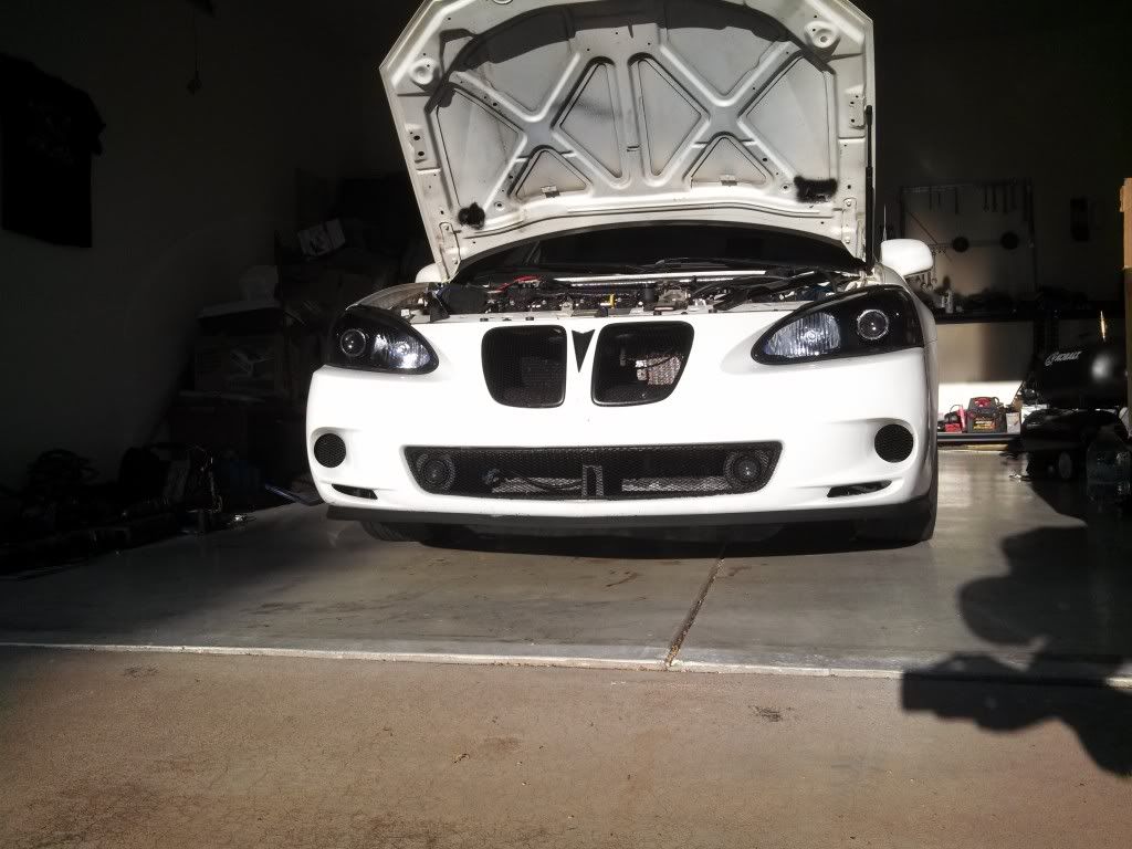

    I had the biggest cooler I could fit in the fender well area back when I got the car. But you will only get 20% surface area coverage of air to actually pass over the radiator. Very inefficient. With that being said you should seriously consider what you're doing if you're trans cooler was mounted like most cars with it in front of the ac condenser you would then have airflow from the huge opening in from plusyour cooling fans drawing air through them.
    As an example here's my old setup which later got a fan mounted but did me no good. This is for a rv BTW.
    But it has nothing on my new setup which is stupid simple cheap and 100x more efficient
