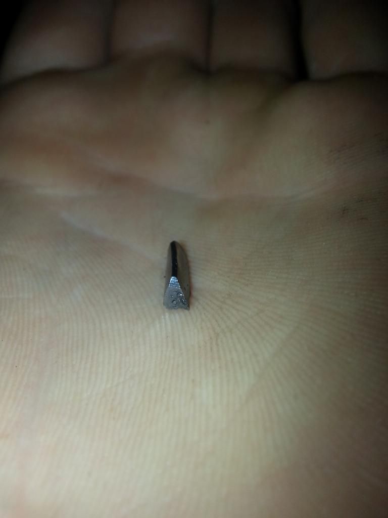

Did you get a picture of the metal?

FYI.... A straight cut gear tooth is not a good thing to find in the pan.

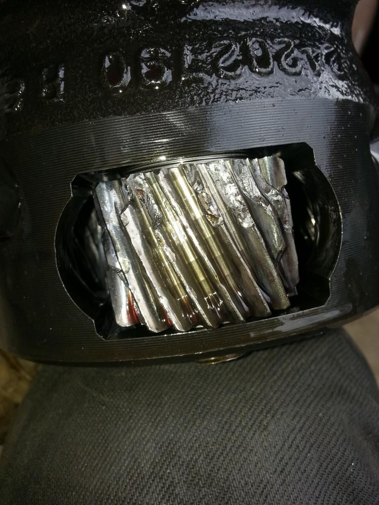

The differential.... is this why I don't have 3rd or 4th. Or did the shavings get into the valve body.
Shavings shouldn't have made it past the filter. When you put that diff back in... it looks like you put the sungear in backwards.
I know ..it fit fine. Putting it in backwards, causes what you see.

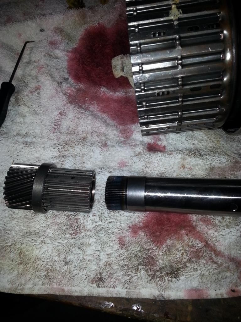

So here is the part the 4th clutch hub goes into. It goes into the 3rd sprag.
http://i1006.photobucket.com/albums/...psnjx9vq8h.jpg
And here is the inside of it. Its called the input sun gear. It looks like all the splines are pretty much gone.
http://i1006.photobucket.com/albums/...ps6kuedtic.jpg
Agreed, this is why you have no fourth gear.
